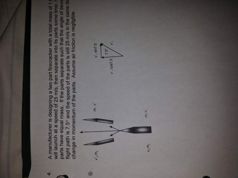

A manufacturer is designing a two part firecracker with a total mass of 1.0 kg. The firecracker will launch at a speed of 25 m/s, then separate into its parts at some time, t, after launch. The parts have equal mass. If the parts separate such that the angle of deviation off the original flight path is 7.5° and the speed of the parts is still 25 m/s in the same directions, calculate the change in momentum of the parts. Assume air friction is negligible.
I tried out the question but I don't get far cause I really have no clue on how to do this question.
Not sure I understand the question. I think it means that each part has the same component of velocity in the original direction before and after separation. If so, what is the direction of the change in momentum of one part? Remember that momentum is a vector.
I attached the pic that came with the problem maybe that will help the understanding because I cannot make heads or tails with this problem

Look at the triangle to the right of the diagram. What is the relationship between the vertical velocity before separation and the vertical velocity after separation? What in that triangle represents the change in momentum?
mass of one part would be half of the original mass so 0.5 kg
is the relationship the change in vertical velocities before and after separation
and is the triangle representing the change of direction of momentum

- we want the change in momentum of one piece; what was its horizontal momentum before the split and what is it after the split?
The horizontal before the split was 0 cause it was going vertical
For one of the pieces I did now
P=mv
(0.5)(25)
=12.5
Then
12.5sin7.5
I get as a horizontal 1.6315
Good. Stop there. You have answered the question.
Then subtract
1.6315-(-1.6315) = 3.263
so the answer to my question of change in momentum would be the 3.263
The sine is not the right trigonometric function...
The right function will give a similar, but not the same result.
No, see haruspex' post. The change for each piece is from 0 to [value close to 1.6 kg m/s], and that value close to 1.6 is the right answer.
No, I said "stop there" after you wrote
horizontal 1.6315
You should add the units, but otherwise that's it: the magnitude and direction of the change in momentum of each part (but they will have opposite signs, of course).
