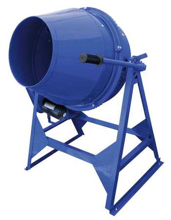

The problem with you not being very descriptive of the application is that it makes it harder for us to try to help you with suggestions and ideas. For example, the mixer you have shown will do a lot of damage to the pieces that it is mixing with its blade arrangement. And as I said, that can also release some chemicals from the mix that really should not be released.
If all you want to do is mix up some stuff to make the mix more homogeneous, then look at alternative mixing technologies that are gentler on the materials, but still do a good job of mixing things together. Consider renting something like a standard cement mixer or similar apparatus instead of using a mechanism with blades...
https://www.zoro.com/marshalltown-c...MI-seEgb-K2wIV1TaBCh05_wAMEAQYAyABEgKG6vD_BwE

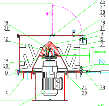

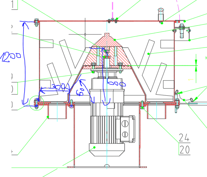

ok :) it is mashine for blending electric trash (300kg) i need to take of this mashine just 50kg for sample and rest for nothing :) ... befor filling ot my machine ... electric trash is crushed destroyed smashed to pieces so i don't care about dameging it :) i just need to calculate forces on padle of this ... bulk material
... about machine this machine have 4padles .. and 6holes to take material out

If the mixer that I posted a picture of does a good job of mixing up the "blend", can you use it instead?
wermix
- 21
- 0
hh :D nope i think ok :D thank you for time but i just need to know how to calculate needed power to rotate paddles :D
wermix
- 21
- 0
russ_watters
Mentor
- 23,771
- 11,197
Is there a particular reason why it needs to be that style?wermix said:
