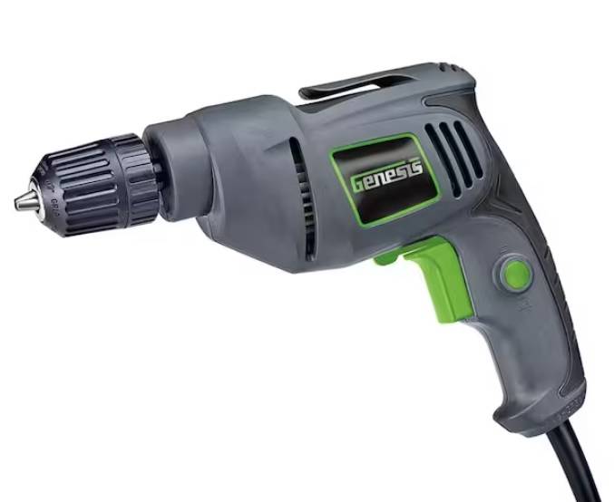

We need all of this information. For example, if it only runs a few hours per week, you don't care what it looks like, and you can fabricate some mountings, one possibility is a low cost electric drill:
The speed can be controlled a screw pushing on the trigger speed control, and they are available cheap. But they are not suitable for 24/7 operation because the brushes wear out.

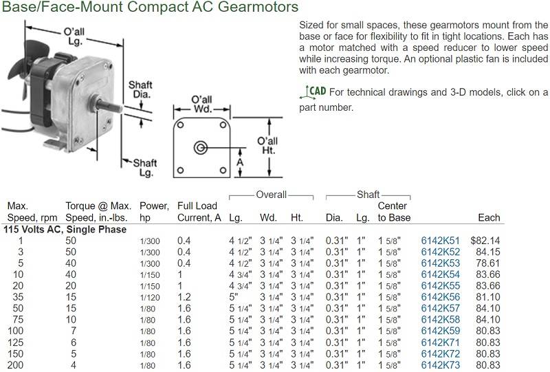

Shaded pole gearmotors are available in a wide range of speeds and power. This is a page from the McMaster-Carr catalog showing one type of gearmotor. They have a large selection of other types. I do not know if they ship to your country, but this gives an idea of what is available:
You will need to spend some time finding what speed and power you need. You might find that you could use, for example, a variable speed drill to find the speed, then buy a gearmotor for that speed.
