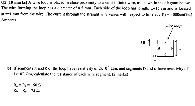

R = pL/A
R(a) = 2x10^-4(0.15)/[pi(0.0005/2)^2] = 152.789 [Ohms]
It is slightly off. Is there a subtle point that I've missed?
Thank you very much.
No, except that when they give you the resistivity and the diameter in 1 digit accuracy each, you cannot return a resistance with 6 digits precision. Because the first digit is a 1, you return two digits. That means 1.5 x 102, but 150 is acceptable generally.
