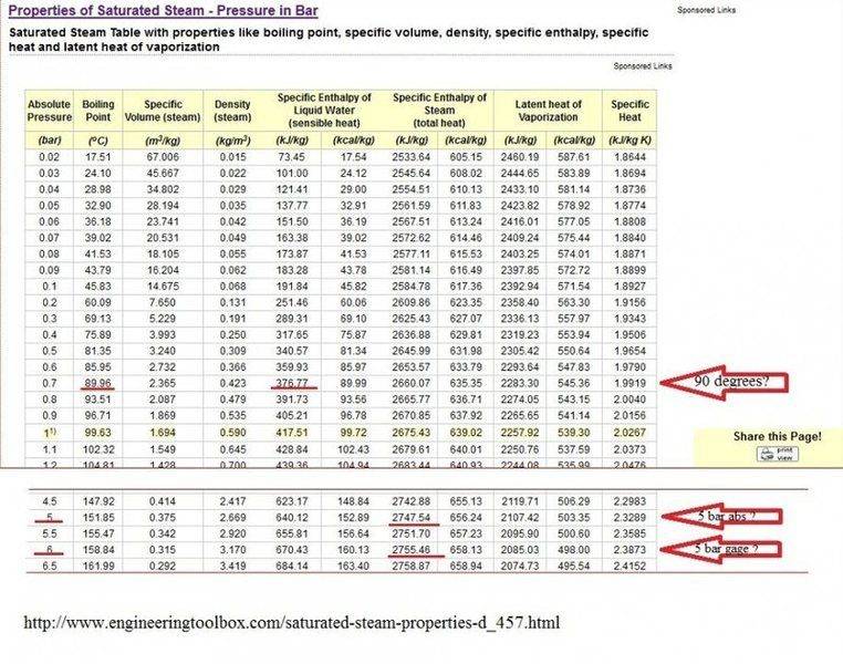

Always cross-check a calculation to see if you're using the right algorithm.
How much energy goes into turn a kg of 90 degree water into 5 bar steam ?
http://www.engineeringtoolbox.com/saturated-steam-properties-d_457.html
Really should use a subcooled water table for hliquid
jim hardy said:
Always cross-check a calculation to see if you're using the right algorithm.http://www.engineeringtoolbox.com/saturated-steam-properties-d_457.html
View attachment 113577Really should use a subcooled water table for hliquid
Apologies Jim, I am not sure what point your are trying to make? The question asks me for the Mass of the steam over an hour. Using the information I have I came up with M = 101.8 KG / H. Have I used an incorrect value somewhere?> I thought the heat capacity of water was constant @ 4.2 KJ /KG up to around 125°C. Since the water is fed @ 90°C I used 4.2 KJ/KG. Should I have used a different figure? I see you have very kindly highlighted 1.99 KJ/KG?? Is this the figure I should have used for Cp?
How does my figure of 108.1 KG / H look?
Sounds reasonable for heating water from 90 degrees to boiling point
I'm more accustomed to BTU's,
MCΔT is for simply heating a substance. A single BTU will heat a pound of water a single degree F
What about a phase change? Takes ~1000 BTU's to boil a pound of water into a pound of steam...
How about in SI units?
I don't see a heat of vaporization in your formula so i don't know what you are using for an algorithm.
Maybe it's in there just i missed it.
That's why it's important to work step by step defining your terms. Explain what each represents. Paint a word picture of your analysis.
