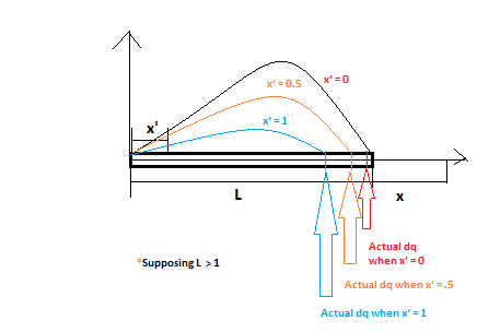

Note: I really apologize for my poor paint skills, but I tried to do my best.
To explain the drawing. It supposed that L > 1 and basically "shows" how I see the x' increasing in my mind.
Ok so, before I used to think "Well, how can I decide in what order to integrate, left to right or right to left? it seems arbitrary"
But by reading your comments, it seems that the integration should always go from the element closer to the potential I desire to calculate to the most distant one. Is this correct?

Yes, I both realize and agree that the answer has to be positive. Still, I would like to understand why I integrate in a certain order to avoid future mistakes.

No, you're missing my point. I'm not saying it's an arbitrary choice made just so that the answer comes out positive. You have to think about the sign of dx'. If you want an individual element λdx' to be positive (which you do, because the charge is positive) then you must integrate from the lower value of x' to the higher value - otherwise dx' will be inherently negative.
