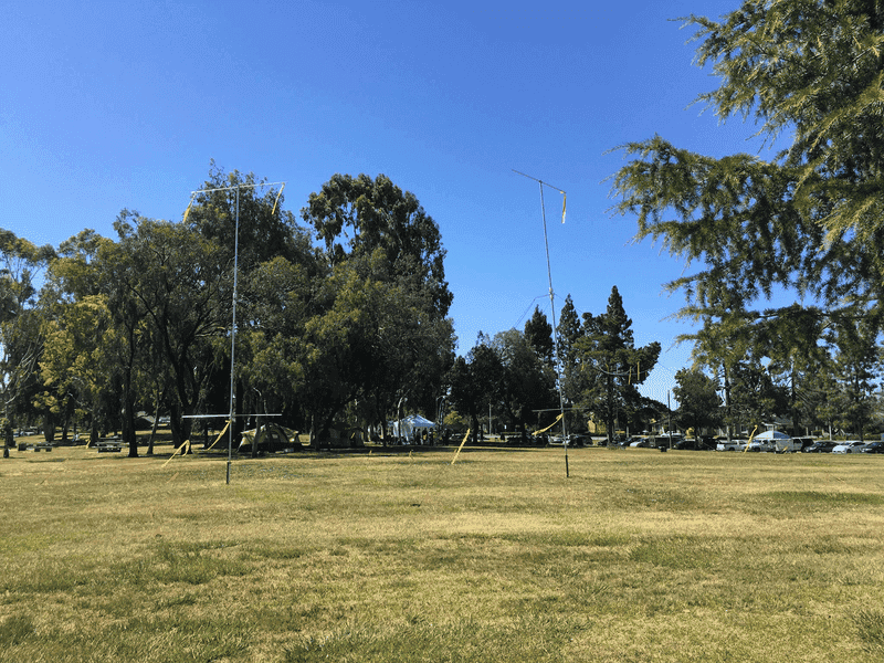

Wow, that's a heavy mast for only 25' long. I've helped put up 50'+ masts at Field Day that were only a couple hundred pounds (we used guy-lines affixed near the top to pull them up and then to brace them to the ground).
@coltonk -- What kind of antenna are you putting on top? Will it also have a rotor motor associated with it? How are you going to affix the bottom of the mast in place once the mast is vertical (pin? other?)?
Similar antennas from Field Day 2016 courtesy of SBARA.org:
