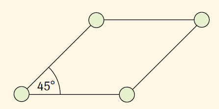

Four objects, each with a positive charge of 1.0 3 1025 C,
are placed at the corners of a 45° rhombus with sides of
length 1.0 m, as in Figure 13. Calculate the magnitude of
the net force on each charge.
F = Kq1q2/r^2

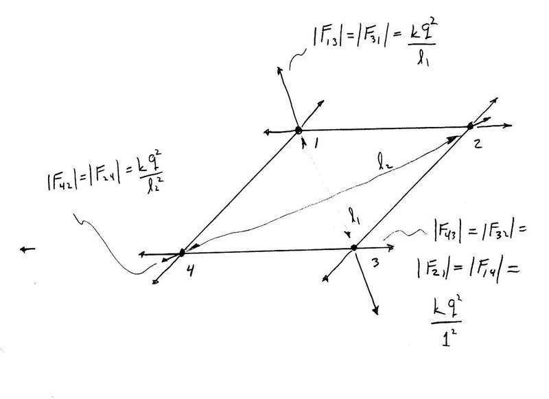

Does this get you started?
yes, thank you I was thinking of something like this.
All I got to do now is do find the component of x and y
