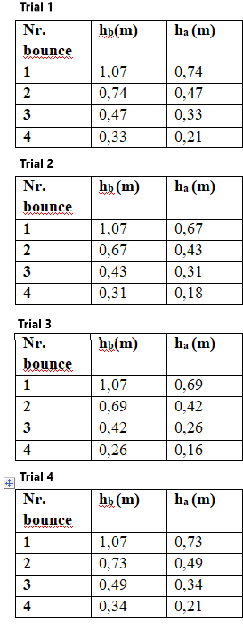

Hey everyone,
I recently performed a lab at school where I had to drop a bouncy ball, let it bounce 4 times, and after each bounce write down the height to which the ball bounces. The procedure was repeated 4 times in total. In each of the four trials, I had variations in the observed heights. Now I have to calculate margin of error.
margin of error: sx̄ = s/√N
Bounce 1, Trial 1-4:
ha (height after bounce)
(0.74+0.67+0.69+0.73)/4=0,7075 this is my mean value.
Standard Deviation, s: 0.033040379335998 (calculated the value using an online standard deviation calculator)
Sample size N: 4
sx̄ = s/√N = 0.033040379335998/√4≈ 0.0165
At a 95% confidence interval the margin of error is 0,0165*1,96=0,03234
So I'm guessing the answer for the first bounce is ±0,032m.
Is this correct and is there an easier way to calculate?
Four tables labelled Trial 1 to Trial 4, each listing bounce number 1 to 4 against hb (m) and ha (m) heights; bounce 1 values are 1,07 with ha 0,74, 0,67, 0,69 and 0,73.
It's been awhile since I've done this type of calculation, but I don't think that's the way to do it. You have found the margin of error for the average of 4 bounces. This cannot be applied to the 1st bounce. Just look at the data from the first bounce. Would you say with 95% confidence that those fall within +- 0.032 m ?

Well, I guess not. Should I instead take the sum of all ha then divide by 16 in order to get the mean value and then calculate the margin of error?
Here is how I understand it. Starting from the same height, you made 4 independent measurements of the height after one bounce. You got a mean value of 0.71 m (you must round to 2 sig figs). You found a standard deviation of 0.03 m. Your measured value is ##\text{0.71} \pm \text{0.03 m}##. Assuming a normal (Gaussian) parent distribution, this means that if you repeat the measurement many times, about 68% of the values will be between 0.74 and 0.67 m. In your specific case it turns out that all your measured values are within that range. If you were to plot this point, you would put a data marker at 0.71 m and add an error bar 0.03 m long on either side of it.

This is not quite right. Consider, for example, if 100 measurements had been taken, still with the same variance in the set of measurements. That calculation would not yield any improvement in the reliability of the mean value, yet the uncertainty in the mean value should be reducing according to 1/√n.
What is wanted is the standard error of the mean.
https://en.m.wikipedia.org/wiki/Standard_error#Standard_error_of_the_mean
If the variance, Average(xi2) - (Average xi)2, of a set of N measurements is σ2 then the standard error of the mean is σ/√(N-1).
In the present case, the 0.033 does not represent σ in this sense because the STDEV algorithm divided by √3 instead of √4. So we should use σ=0.033*√3/√4. The standard error of the mean is then σ/√3 = 0.033/√4.
