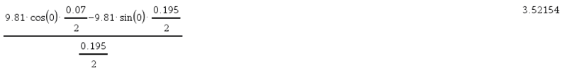

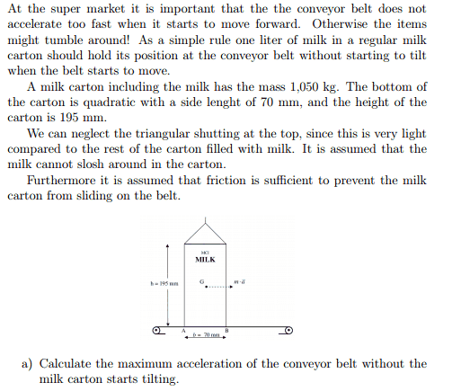

∑Mb = m*a*d
Using the formula below i get:
m*g*cos(0)*(0.07/2)-m*g*sin(0)*(195/2)=m*a*h
And I get 3.52 m/s^2
Is it correct?
So do I.
haruspex said:
So do I.
Thank you for your response.
