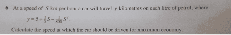

This is the problem,

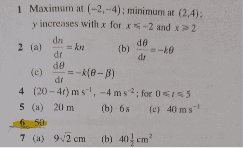

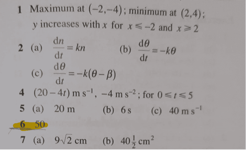

This is the textbook solution ; i think the textbook solution is not correct!
My thought,
##S_{max}## will be given by $$\frac {dy}{dS}=0$$
$$\frac {dy}{dS}=\frac {-1}{400}S+\frac {1}{5}=0$$
$$S=80$$
It is maximum economy because ##y{''}<0##, i.e by use of the second derivative test.

This equation doesn't make sense, as it says that ##S_{max} = \frac {dy}{dS}## (not true) and that ####S_{max} = 0## (also not true).
I understand what you're trying to say, but this isn't the right way to say it.

I get 80 (km/hr) as well.

That's why we use the second derivative test to ascertain that...Looks like textbook guys were after all wrong. Cheers Mark.
