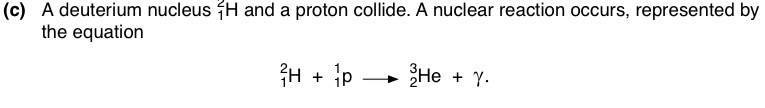

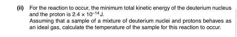

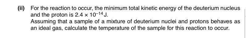

1. Homework Statement
KE = 3/2 R/NA T
By using the formula above, I used 2.4 x 10^-14 J as the mean translational KE , but it should be 1.2x10^-14 , why? I thought the mixture contains both deuterium nucleus and the proton? Why half KE of mixture?

what happens to the particles kept at some temperature-they get energy and start thermal motion - the average K.E. of particles is related to the temp. and Boltzmann Constant.
3/2 is a factor depending on degree of freedom.
so, what amount of energy a particle say proton will get if you are given with Total K.E. of proton and deuterium? that one should find and then apply the energy-temp relation.

At a given temperature, how much KE will each particle have? (You have to assume some collisions will be head on.)

Half of the total KE, but why? I thought they are asking for the sample? Why do we need to consider KE of just one of them?
They are asking for the temperature at which you would expect the reaction to occur. It doesn't have to occur for all particle pairs immediately. Leaving aside that some will have greater than the average KE, they will be moving in various directions. From the temperature you can find the average KE of any given particle, but the reaction involves two particles. Their relative directions of travel matter. Which case makes them most likely to reach the required KE level?

well it does -but the question is being asked as to why half of the total KE of the two (given in the question) is being used for estimating T.
When they collide head-on?
Does it mean that we have to supply 1.2x10^-14 J of energy to both deuterium and the proton for the reaction to start?
It means that given those average KEs each, you can expect the reaction to start.

Ok, got it, thanks very much!
