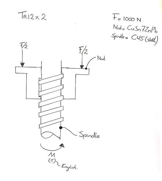

Hello,
I have a design with using a lead screw to move a load (see sketch below). The load will operate in both directions, in order to select the right DC motor and coupling (flexible coupling) I want to calculate how many torque is needed to move the load (for both directions. I found out the following and hope I am on the right way:
  1. Material nut = CuSn7ZnPb (Bronze)
  2. Material spindle = C45 (Steel)
  3. Friction for Steel/Bronze according Shigley = 0.2
  4. Load (F) = 1000 N = 1000/2 = 500 N
  5. Spindle and nut are Tr12 x 2
From my calculation I found a needed torque of 0.73 Nm. Is this correct? Besides, is this torque constantly needed of is this the peak torque ?

Sketch:
Hand-drawn sketch of a Tr12 x 2 lead screw with a nut, labelled F = 1000 N, Nut = CuSn7ZnPb, Spindle = C45 (steel); load arrows F/2 act on the nut and a torque M (T) arrow is shown on the spindle.
  • Hand-drawn sketch of a lead screw and nut labelled Tr12 x 2, with F/2 arrows on the nut flange, a torque arrow M (T) on the spindle, and notes F = 1000 N, Nut = CuSn7ZnPb, Spindle = C45 (steel).

According to Shigley’s Mechanical Engineering Design the formula is: $$T_{R}=\frac{F d_{m}}{2} \left( \frac{l+ \pi f d_{m} sec \alpha}{\pi d_{m}- fl sec \alpha} \right)$$
where: ##F## - axial force, ##d_{m}## - mean diameter, ##l## - lead, ##f## - friction coefficient, ##\alpha## - half of the thread angle.
The quick and easy way to cross check your torque calculation is to search torque tension chart. Look for the closest standard thread, then scale the results to your load. A 12 X 1.75 mm bolt with 500 N load came to slightly more than 1 N-m torque. That is for a V-thread bolt, so your calculation of 0.73 N-m for a square thread looks good.
If you are turning the screw, then you need to add the friction between the screw and the load. If turning the nut, there is bearing friction for the nut.
Your friction value of 0.2 is for smooth steel against smooth bronze, well lubricated, and while moving. If the screw thread is machined (not ground), it is not smooth. Static friction is typically higher than dynamic friction, especially if it sits without moving for long times (hours or days). A safety factor is a good idea. I suggest a friction value of 0.5 to account for these factors, which would increase your design torque to 1.8 N-m.
You seem to have divided your required force in half for your calculation. Do you have two of these power screws in parallel?

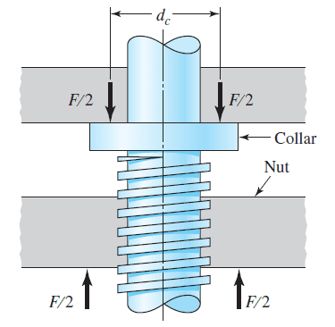

What I was also wondering, should I take into account collar bearing calculation? As shown in the sketch in the first post, I don't think it's the case here. Or do I miss something here? Torque collar bearing formula:
Equation for collar bearing torque: Tc equals F times fc times dc divided by 2, where F is the axial force, fc the collar friction coefficient and dc the collar diameter.

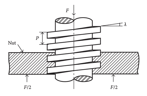

Because I have a force of 1000 N loaded at the spindle, this results in the F/2 as shown in the image below:
Diagram of a screw thread engaged in a nut: a vertical threaded rod with axial load F applied at the top, lead P marked between adjacent threads, helix angle λ shown at the thread flank, and reaction forces F/2 shown at the nut's two sides.
this results in 2 x F/2 = F.
You're still effecting a total force of F, which has to be accounted for. If you're only considering the torque required for one side of the nut, you'd still have to multiply by 2 to account for the other side as well.
The derivation is done by unrolling the screw, which would wrap both (F/2) into the total F. Notice that the base of the triangle is the circumference of the screw. Both sides are included in F.

Thank you Onatirec. Should I also take the collar friction into account? It would have a significant affect on the total torque.
It's not clear from your diagram that you have a collar on the screw. If you have one, you should account for the friction; if not, then no.

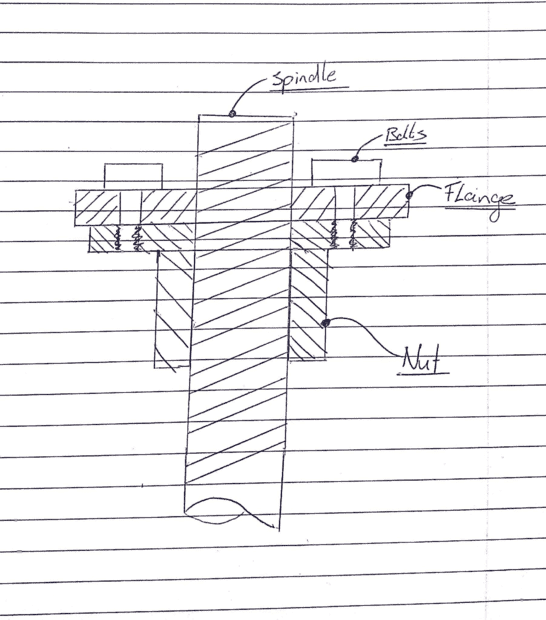

This (below) is what I have. The flange where the nut is mounted on, should been seen as the collar I assume?
Hand-drawn cross-section of a threaded spindle passing through a flange with bolts on either side and a nut below the flange, with labels for spindle, bolts, flange and nut.
You can see in my post #12 above that the collar is attached to the screw and spins against the gray surface above it. The additional friction between those two surfaces is what the collar torque (Tc) has to overcome.
In your diagram the flange is bolted to the nut. So there doesn't appear to be any additional frictional surfaces protruding from the screw (in addition to the threads).

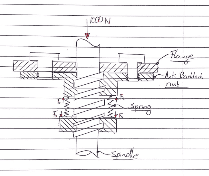

On the internet I have seen "anti backlash nuts" Anti backlash nut example (see image), I searched on the forum but couldn't find any related topics. But it has made me interested how this should be considered as there is (in my opinion) another force namely, the Force occurred due to the spring (Fs). Does it makes the sketch with the forces as drawn below? Should this spring force be added to the axial load force? So this will increase the total axial load force?
Hand sketch of an anti-backlash nut on a spindle, with a 1000 N downward arrow on the top flange and two split nut halves pressed by springs labelled Fs on each side.

1) A solid part with a load, such as a screw or nut, with a force on it has one force F. It can be shown as two forces, where each force is F/2, in order to make it clear to which part the force is applied. The total force on the part is then 2 * F/2 = F.
2) Assume a screw with a force F. In the homework world, that force is applied against a nut, and the assigned problem is to calculate the torque given a friction coefficient. The screw is rotating in space, and the force is applied by magic. There is one calculation of friction.
In the real world, something is applying that force to the screw. That something can be the end of the screw pushing against something else, a collar, or it can be a bearing. That something has a friction that can be calculated, and adds to the torque required to rotate the screw. There are at least two calculations of friction, with the results summed.
3) The diagram in Post #12 clearly shows the screw load being applied by a collar on the screw. The forces F/2 should be one force F on each part. Splitting the force F into two forces F/2 is confusing. Although it is difficult to properly show a single force F on each part in a simple diagram.
4) The diagram in Post #13 is confusing. It does not show what part is carrying what load.
5) I suggest that the OP clarify whether this is a simple homework problem, a simple homework problem that lead to questions about collars, and if they now understand screw threads and friction.
