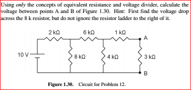

Calculate the voltage between points A and B
16 replies · 10K views · last reply
Kelsi_Jade
58
Circuit schematic for Figure 1.30: 10 V source feeding a 2 kΩ and 6 kΩ resistor in series, then a 1 kΩ resistor to point A, with an 8 kΩ resistor and a 4 kΩ resistor in a ladder down the middle and a 3 kΩ resistor on the right to point B.

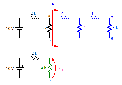

You started by finding the equivalent resistance that parallels the 8 kΩ resistor, reducing that pair to a single resistance and applying the voltage divider rule to the reduced circuit:
Two circuit schematics: the top shows a 10 V source, a 2 k resistor, a 8 k resistor between nodes a and b, and a 6 k, 1 k, 4 k and 3 k network ending at terminals A and B, with Req marked; the bottom reduces to a 10 V source, 2 k resistor and 4 k resistor between a and b, with Vab marked.
Note that the nodes a and b are not A and B. What you've found is the voltage Vab that will appear across the 8 kΩ resistor in the original circuit. With that you can replace everything to the left of the red dividing arrows with a voltage source equal to Vab:
Circuit schematic with source Vab across nodes a and b, a 6 k resistor on top, a 4 k resistor from node c to node d, a 1 k resistor and a 3 k resistor to nodes A and B, and a red vertical cut line labelled Req2.
and you're ready to repeat the process to find the voltage Vcd.
