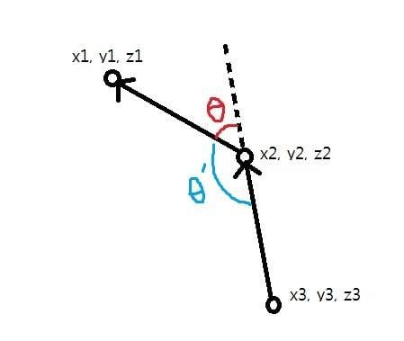

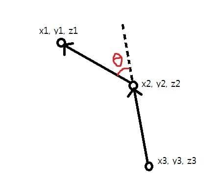

I'm so confused about finding an angle, theta in this illustration.
With having three coordinate information, how can I calculate the theta using dot product?
I would easily find the angle by using trigonometric formula if I ignore the z-axis.
But I want to solve this problem with 3-dimensional coordinate system by using dot product formula.
Please help me confused.
There are two definitions for dot product of two vectors.we have [itex]\vec{u}\cdot\vec{v}=u_xv_x+u_yv_y+u_zv_z=uv\cos{\theta}[/itex].

Yes, I've already known that formula but could not understand exactly.
Could you help me more detail about such variables?
I was wondering about what is u_x, v_x, u_y, v_y... in this case.
I think 'u' is (x1-x2, y1-y2, z1-z2) and 'v' is (x2-x3, y2-y3, z2-z3). Is this correct?
Thank you for your support :)
[itex]u_x,v_y,...[/itex] x,y and z components of the vectors u and v.They can be anything! [itex](x_1-x_2, y_1-y_2, z_1-z_2) and (x_2-x_3, y_2-y_3, z_2-z_3)[/itex] are just particular examples when u and v are displacement vectors.You just have to find the components of the vectors and then their magnitudes.

In this example, yes. And when Shyan writes ##uv\ cos\theta##, here u and v are norms of the two vectors. Just in case it wasn't clear.

I have one more question
In this case, should I just do 180' minus the theta calculated by using dot product formula to find the theta prime(')?
Thanks!
Yes.
There exists a plane containing both vectors, and in that plane, all the planar geometry you know applies. So θ and θ' are complimentary angles, and therefore, their sum is 180°.
