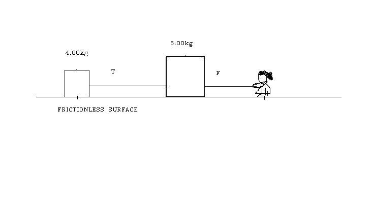

The crates are on a horizontal frictionless surface. The woman (wearing golf shoes so that she can get traction) applies a horizontal force F = 50.0N to the 6.00kg crate.
a.) what is the magnitude of the acceleration of the 6.00kg crate?
b.) what is the tension T in the rope (of negligible mass) connecting the two crates?

But she's not moving only the 6 kg crate! Yes, the 50 N force is on the 6 kg crate but there is also a force (that you don't know yet) caused by the drag of the 4 kg chart.
In essence she is moving both crates: a total of 10 kg. There common acceleration is
[tex]\frac{50}{10}= 5 m/s^2[/itex]<br /> (you have your fraction upside down! Since F= ma, a= F/m, not m/F.)<br /> <br /> Now, what what NET force would produce that acceleration in the 6 kg crate alone? (F= ma= (6)(5)) The difference between that and the 50 N is the "drag" of the 4 kg crate and is the tension in the rope between.[/tex]

so 20N is the tension between the crate
i think when you already have an acceleration you can instantly compute for the tension between 4kg and 6kg mass... using the 4kg mass,
so 4kg(5m/s^2) = 20N
right on. the tension is the only force moving the 4kg mass.

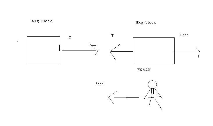

w8 how would i draw a free body diagram on the two blocks including the woman? and the forces acting on each body?
F is 50N from the problem, you have the acceleration of the blocks(that is 5m/s/s).
only force on 4kg block is tension in the rope.
on the 6kg block, net force in the direction of acceleration or motion is applied force - tension in the rope.
on the lady, friction balances the 50 N
