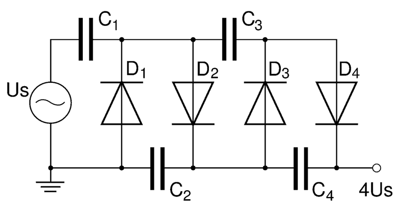

I would like to attach a LED to the circuit, but the LED requires 1,5V to operate.
So i though to add a capacitor to store the generated energy until it is sufficient to create a 1.5V current.
So far so good?
What capacitor (or other solutions) should i use?
I am aware of the fact that this circuit produces AC power and that i will need to place a diode before the capacitor, and after the LED, to ensure the capacitor is actually charged.
Create a current at 1.5V for how long a time? As soon as the LED is attached, the energy stored in the capacitor will be depleted and the voltage will go down. Therefore, at best you can get the LED to flash for a short period of time.
A single capacitor won't get you to 1.5 volts. You need a circuit like the ones in this article:https://en.wikipedia.org/wiki/Voltage_multiplier
But even that won't work unless you have enough power. Voltage and power area not the same thing. Power=Voltage*Current. You need to find out how much power your device makes, not just the voltage.
