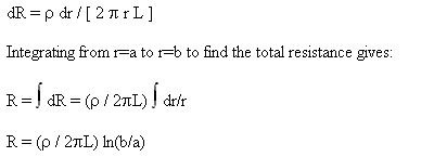

Determine the insulation resistance in a coaxial cable of length L, with conductivity, as shown in Figure assume that the current density J is radial direction.
so i was wondering if this approach is correct,
consider a sequence of cylindrical shells of radius r and thickness dr. Each shell has a resistance dR given by:
This has already been posted and responded to.
The method is correct this time (I seem to recall it changed from the last post).
