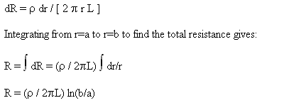

The insulation resistance in a coaxial cable of length L can be determined by analyzing the resistance of cylindrical shells with radius r and thickness dr. The current density J is radial, which influences the resistance calculation. The approach of using cylindrical shells to derive the total resistance is correct and aligns with established electrical engineering principles.

Determine the insulation resistance in a coaxial cable of length L, with conductivity, as shown in Figure assume that the current density J is radial direction.
so i was wondering if this approach is correct,
consider a sequence of cylindrical shells of radius r and thickness dr. Each shell has a resistance dR given by:
