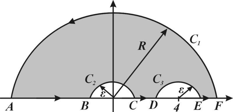

I probably need to calculate this integral with complex residues calculus, but I'm having difficulty with it:
[tex]\int_{0}^{\infty}\frac{dx}{x^a(x-4)}[/tex]
where 0<a<1 is real number.
I mean trying to find a closed contour here seems to be a pain in the neck, I mean how do i calculate the residue of 1/(x^a), assuming my contour runs with a circle around it (not from inside the curve but outside it, i hope it's clear.
thanks in advance.
if a where an integer I would know how to do it, not by residues.
If you want to solve this by residues, I have no idea.
It have to bee solved analytically?
And the pole in x= 0 is of the order a, which is a real number, not an integer. No ideas.
You need to put a cut from the singularity at the origin to infinity. Have it go along the real axis but skirting round the pole at x=4. Now look for a closed contour that does not cross the cut. When you go round the singularity at the origin in a small circle you pick up a factor...

Try the following contour, and the integral
[tex]I=\oint_C\frac{d\,z}{z^\alpha(z-4)}=\oint_C f(z)\,d\,z[/tex]
Since there are no ploles inside [tex]C[/tex], we have [tex]I=0[/tex].
It is easy to prove that
[tex]\int_{C_1}f(z)\,d\,z=\int_{C_2}f(z)\,d\,z=0[/tex]
and
[tex]\lim_{\epsilon \rightarrow 0}\int_{C_3}f(z)\,d\,z=-4^{-\alpha}\,i\,\pi[/tex]
Now write down the rest of the integrals, and equate real and imaginary parts. You should arrive to
[tex]\int_{0}^{\infty}\frac{dx}{x^a(x-4)}=4^{-\alpha}\,\pi\,\cot(\pi\,\alpha)[/tex]
Be careful for the AB integral. There [tex]z=x\,e^{i\,\pi}[/tex]
EDIT Change sign in [tex]C_3[/tex] integral.

shouldn't the integral of C_3 when epsilon approaches zero equal minus what youv'e wrriten, we learned it should be this way.
besides, this thanks, i did it before i asked, i just wasn't sure what is a_-1 of 1/z^a, but from writing i guess it should be zero, correct? (when a is between 0 and 1).
You are right for the integral of [tex]C_3[/tex]. I changed it in my previous post. Calculations are not my best thing! :smile:
Now let's denote [tex]I[/tex] your integral. The integral on AB is
[tex]\int_{-R}^{-\epsilon}\frac{e^{-i\,\pi\,\alpha}}{x^\alpha(x+4)}\,d\,x \xrightarrow[\substack{\epsilon \to 0\\ R \to \infty}]{} e^{-i\,\pi\,\alpha}\,\int_{-\infty}^0 \frac{d\,x}{x^\alpha(x+4)}=e^{-i\,\pi\,\alpha}\,J[/tex]
Thus we have
[tex]\oint_C f(z)\,d\,z=0\Rightarrow I+e^{-i\,\pi\,\alpha}\,J-i\,4^{-\alpha}\,\pi=0 \quad (I,J) \in \mathbb{R}[/tex]
In this equation equate real and imaginary parts, in order to arrive to the wanted result.

Do we agree that in contour at hand
[tex]\oint_C f(z)d\,z=0 \, ?[/tex]
Then
[tex]\oint_C=\int_{C_1}+\int_{AB}+\int_{C_2}+\int_{CD}+\int_{C_3}+\int_{EF}=0[/tex]
At the limit [tex]\epsilon\to 0,R \to \infty[/tex]
  • The 1st and the 3rd integral vanishes.
  • The 4th and the 6th integral combine to
    [tex]I=\int_{0}^{\infty}\frac{dx}{x^a(x-4)}[/tex]
  • The 5th integral gives
    [tex]\int_{C_3}f(z)\,d\,z=-4^{-\alpha}\,i\,\pi[/tex]
  • The 2nd integral
    [tex]e^{-i\,\pi\,\alpha}\,\int_{-\infty}^0 \frac{d\,x}{x^\alpha(x+4)}=e^{-i\,\pi\,\alpha}\,J[/tex]
Now apply what is said in my previous post and you will calulate both
[tex]I=\int_{0}^{\infty}\frac{dx}{x^a(x-4)},\, J=\,\int_{-\infty}^0 \frac{d\,x}{x^\alpha(x+4)}[/tex]
This is a general trick, applied when you have a pole on the real line and the integral "passes" through it, i.e. Cauchy principal value.
Does this clears up things? :smile:
