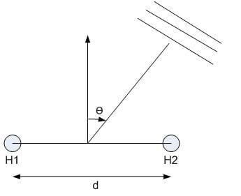

I am simulating signals on two hydrophones H1 and H2 of linear array which are at a distance 'd' from each other. The geometry is shown below:
Assuming Plane Wave assumption, there will be some 'delay_' b/w 8.5KHz source signal arriving at H1 and H2 assuming zero noise and pure sinusoidal signals. MATLAB script given below:

The delay_ value calculated is around 0.0064s. The literature says we can estimate source angle by calculating the delay b/w two sensors (i.e. H1 & H2) using cross correlation techniques.

Find, but it is premature to apply your code to the actual problem when it is not working as expected.
At this time, I wouldn't worry about your ultimate application. See if it works on some simple cases.
You also might want to run the xcorr() program that finddelay uses and see what it gives you. That might make it obvious what is going on.
