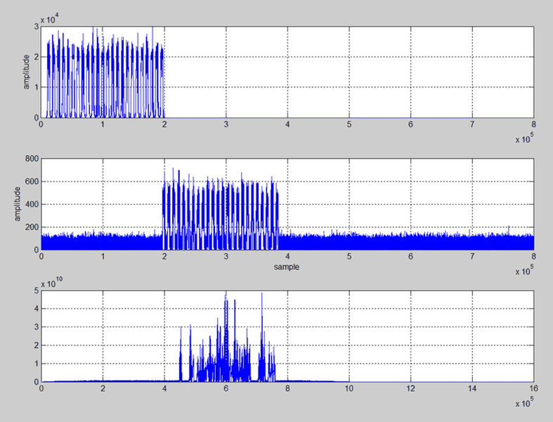

sophiecentaur said:
That will depend a lot on the nature of the data. If you have truly random data then there would be only one maximum with the rest of the values being zero. If the data has ' repeating' sequences, for instance. there can be spurious smaller peaks. It's a matter of the autocorrelation function.
the data has ' repeating' sequences for every second, the RX data is representing for 10 second and they are kind of repeating, therefore I just need to separate for 1 second, then do xcorr, the expectation will be only 1 peak of maximum value, Please look at the the attached file, do you see it's weird?
  • Three stacked MATLAB-style plots of amplitude against sample, with grid lines; the top shows a burst of pulses from about sample 0.1 to 2 x 10^5, the middle a burst of pulses from about 2 x 10^5 to 4 x 10^5 over a noise floor, and the bottom a burst of spikes from about 4.5 x 10^5 to 7.5 x 10^5.
What are we looking at here?
Three time charts: tx, rx, xcorr? No, that can't be right -- the scale of the 3'rd graph Y axis is too large to be xcorr.
One second of data? No, that can't be right -- 8x105 data samples at 8MHz would be 1/10 second.
I'm getting tired of trying to figure this out.
