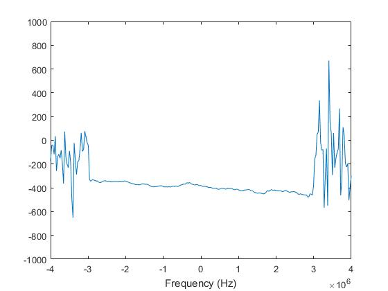

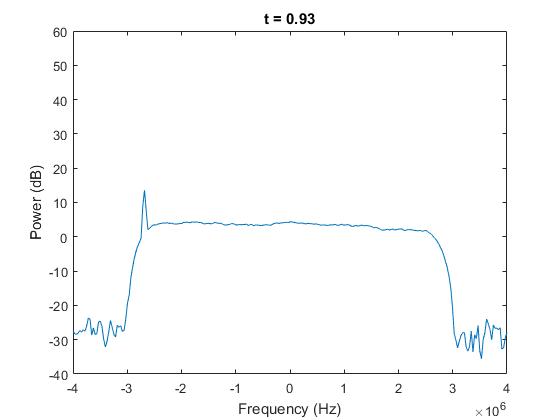

@ Baluncore : I understand my situation, this is more complicated when I keep asking you, I think you have your ideas, someone else have different ideas. As you said, we can use 1 rx antenna and follow this instruction from you. and I will try it.
Again, this is a signal from the digital tv transmitter or digital tv station, after collecting data and process with multipaths included, it will give us these plots for the phase and magnitude (look at the attached files with the name abs_original.jpg and phase_original.jpg)
Now, I am trying to assume there are no multipath or only 1 direct signal and 1 multipath. The observations and expectations are similar to the original (plots), from there I can see something and experience to detect multipath signal. Is it right? (you can look at my code file which is also attached).
the antennas which I am using, are < https://www.dxengineering.com/parts/dmn-srh815?seid=dxese1&cm_mmc=pla-google-_-shopping-_-dxese1-_-diamond-antenna&gclid=Cj0KEQiAnvfDBRCXrabLl6-6t-0BEiQAW4SRUHVgbNXzPhNr0FIcRXoX5OEACvSXVAoranPUOk_-yqYaAhCF8P8HAQ >
  • Power spectrum plot titled t = 0.93, power in dB against frequency from -4 to 4 MHz, flat passband of about 2 to 4 dB between -2.5 and 2.5 MHz with a sharp spike near -2.7 MHz.
  • Line plot of amplitude in dB against frequency from -4 to 4 MHz, flat near -400 dB across the band with spikes near the band edges.
