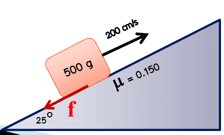

The brick mass 500g is pushed on hill with velocity 200 cm/s, how far can the brick reach before it stops when μ=0.150
W=Fdcosθ
E=1/2mvv
I got about 1 m before the brick stops, does it correct?
How did you calculate 1m?
I calculated how much energy in the brick after it was pushed with Kinetic equation and I got 1 J, when the brick stops moving it means the energy was consumed by the friction till 0J, I can find work by W=(delta)E and I got 0-1= -1 J
-1=Fdcosθ
F is friction force = 0.735 N
d is the displacement
cosθ is anagle between F and d (180 degree) = -1
-1=(0.735)(d)(-1)
it is about 1m (significant digit has only 1 )
Aren't you forgetting something? Hint: What would happen if friction were zero?

The way to calculate F is to start by calculating the normal force of the 500g block on the ramp. A free body diagram would allow you to clearly see what forces act on that block. Concentrate on the [component of] the forces in the direction perpendicular to the ramp. There are two. The block does not accelerate perpendicular to the ramp. That gives you an easy equation to solve for the normal force.

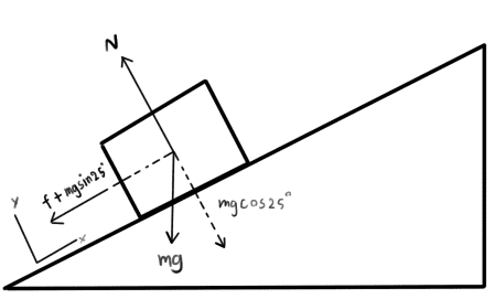

Did I miss something? I guess I will never find answer until I can draw correctly
That is correct, as long as you bear in mind that the mg sin(25) and mg cos(25) terms replace the mg term. They should not really all be shown in the same diagram.
here is my final equation
PE - KE = Fdcosθ
mgh - 1/2mv2 = ( μmgcos25+mgsin25 ) d cos180
gh - 1/2v2 = [ μg(0.9) + g(0.42) ] d (-1)
(-9.8)(dsin25) - 1/2(2)2 = [ (0.150)(-9.8)(0.9) + (-9.8)(0.42) ] d (-1)
(-9.8)(d)(0.42) - 2 = [ -1.323 + -4.116 ] d (-1)
-4.14d-2 = 5.44d
d = -2/ (5.44+4.14)
d = -0.20 m
and again the displacement is negative it means the direction of the displacement is opposite of the friction , What if I want displacement to be positive?
