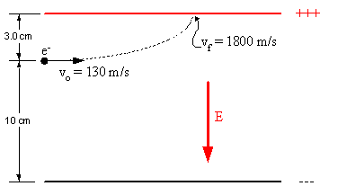

An electron traveling 1.3*10^2m/s enters the region between two parallel plates at the distances shown. When it collides with the plates, it has a speed of 1.8*10^3 m/s. What is the electric field between the plates? What is the electrostatic force on the electron? And how far along the plate does the electron hit?
|3.0cm (3cm between electron and top plate (positive)
electron
|10cm distance between electron and negative (bottom plate)
------------- negative
I tried using V= ΔE/q but than realized that i probably had to use E = ΔV/ΔD
I really don't know how to go about this. You don't have to give me all the answers, just some steps please

Do they give you the distance between the plates in the problem statement? I don't see how you can tell what distance the electron has traveled without knowing this distance. If I understand the problem statement correctly, they give you the relative distances of the electron to the plates at either end but not the separation. Or maybe it's the case that it enters at 3cm below top plate in which case you would know the distance.
skg94 said:
I don't think i got the potential difference right, because i tried all 9.2*10^-6 / 3*10^-2 and 10^-2 and 7^-2 i tried all the denominators and i never got an answer on the sheet
Well, 3.0 cm is 0.03 m, or 3 x 10-2 m.
Why, what are the choices on the sheet? Is the problem statement exactly as you've written it?
Yes it is the distance between plates is given the length of plates is not.
The distance is 3cm from the top plate to the electron ( just coming in) an 10cm from the electron to the bottom plate.
Would itbe bettet if i took a picture of it?
This is my understanding of the setup:
Diagram of a parallel plate capacitor with a red top plate marked +++ and a black bottom plate marked ---, separated by 10 cm. An electron e- enters 3.0 cm below the top plate with v0 = 130 m/s and follows a dashed curved path to the top plate, labelled vf = 1800 m/s. A red arrow labelled E points downward between the plates.
Yes that's right except the curvature isn't drawn on mine but that diagram is accurate

It's possible that the given answers are incorrect (they may correspond to a previous revision of the problem where the given values were different).
What value did you calculate for E?
I highly douby its wrong its a pracice diploma but i calculated using .03 as d
3.06666...x10^-4
Using the 9.2x10^-6V
Well, that looks okay to me.
You can confirm by determining the work done on the electron by that field in moving through the 3.0 cm, and from that find the final velocity in the y-direction (work-energy theorem). The net velocity (add the components) should equal the final velocity as given.
Wait isn't the energy work E=hf-w right? I am confused as to hat you just said
The work done in moving the electron through distance h with force f is fh. That will also be the KE imparted. So ##\frac{1}{2}m_e v_y^2 = f h##. Solve for the ##v_y## and see if it, combined with the initial x-direction velocity, produces the given final velocity.
To find the distance along the plates, use the kinematic relations. You know the resultant velocity vector is of magnitude 1800m/s with an x component 130m/s. The x component of velocity stays a constant 130m/s since the only force acting on it (in addition to gravity) is the electric force which is perpendicular to the x direction. From this information, find ##v_y##. Alternatively, gneill's method works too.
You should also be able to find the electron's acceleration and then use kinematics.
