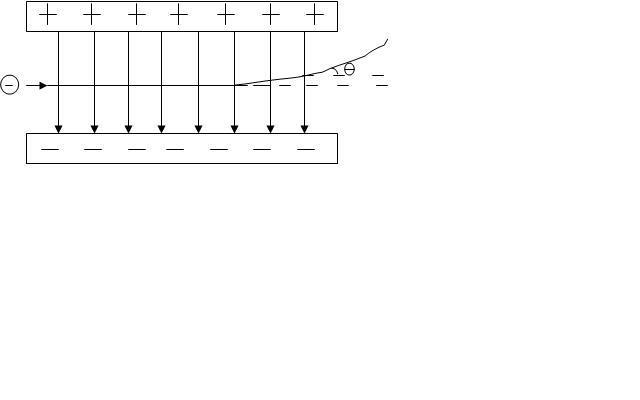

Question:
An electron with a velocity of 3.00x10^6m/s[horizontally] passes through two horizontal parallel plates, as in the attached diagram. The magnitude of the electric field between the plates is 120N/C. The plates are 4.0cm across. Edge effects are negligible.
a) Calculate the vertical deflection of the electron.
I'm not sure what I should do here and I would appreciate any help. I think it might be [tex]\epsilon[/tex]=[tex]\frac{kq}{r^2}[/tex], but I'm not exactly sure. Thanks.
What's the force on the electron while it's between the plates? The resulting acceleration? How long does it spend between the plates?
That's an equation for the field from a point charge, which is not relevant here. You are given the field, so find the force.
