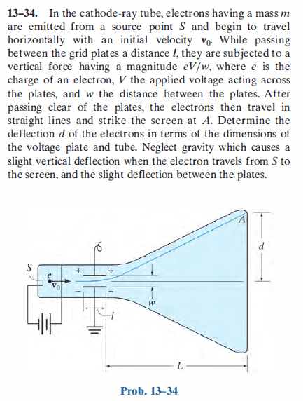

In the cathode-ray tube, electrons having a mass m
are emitted from a source point S and begin to travel
horizontally with an initial velocity v0. While passing
between the grid plates a distance l, they are subjected to a
vertical force having a magnitude eV/w, where e is the
charge of an electron, V the applied voltage acting across
the plates, and w the distance between the plates. After
passing clear of the plates, the electrons then travel in
straight lines and strike the screen at A. Determine the
deflection d of the electrons in terms of the dimensions of
the voltage plate and tube. Neglect gravity which causes a
slight vertical deflection when the electron travels from S to
the screen, and the slight deflection between the plates.
See attachment for picture

y2 = d = 1/2*eV/mw*l^2/v0^2 + eV/mw*L/v0
It appears the solution is missing the left term I keep getting, any idea why?
  • Diagram of a cathode-ray tube showing electron source S, grid plates separated by distance w with length l, screen at A, dimensions L and d, labelled Prob. 13-34, with initial velocity v0.
The solution is missing that term because they are neglecting the slight deflection between the plates, as mentioned at the end of the problem statement.
