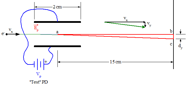

That is not too bad an approximation, but it underestimates the curvature of the trajectory while the electron is between the plates. The electron is accelerating and covers more distance in the latter half of the plates than the front half. A better approximation can be made by taking the center of the plates as the vertex of your triangle. Triangle abc in the image:
Diagram of an electron beam deflected between two parallel plates: e- enters from the left with velocity vx, the plates are 2 cm long, the screen is 15 cm away, and a test potential Vp is connected across the plates, with the deflected path marked red and points a, b and c labelled.
You should also note that the velocity triangle depicted is similar to triangle abc. You didn't need to find the angle, you could simply have set up a ratio.

gneill said:
The 0.16 came out of nowhere, but I'm guessing that you used the distance from the front edge of the plates to the screen in meters?
Yes, I used 15 cm + 2 cm / 2 = 16 cm and 0.16 in m.
I don't understand, what do you mean by a ratio?

0.15 / 41 931 393.47 = dy / 1 677 256
dy = 6 * 10-3 m.
dy = 6 * 10-3 m.
Yes.
That's the deflection for your choice of deflection potential ##V_p##. Use it to write the sensitivity (mm/V).
gneill said:
Yes.
Hm, so we change m into mm 6 * 10-3 m → 6 mm and then divide by VP, which I took as 100 V: 6 mm / 100 V = 0.06 mm V-1. That's indeed the correct answer!
