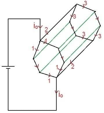

This is my attempt:
Wireframe hexagonal prism drawn in oblique projection, connected to a battery on the left; black edges are resistor branches, green edges are unlabelled, and red arrows and numbers 1, 2 and 3 mark current directions and branch groups, with i0 at the input and output.
just extended branches a little :-p
I just simply used symmetry !
And i have numbered the currents .. and green branches have no current !
So net resistance becomes ... oops .. can't write answers ... or i'll have another Infractions ...
oops ... but you can figure it out anyway ...
please some expert tell me if I'm right
anyway here's my answer :
(Point on it to see the answer ... but please do it yourself first before checking my answer ...)
... 21R/20 ...

SammyS said:
Also, are you familiar with Y - Δ transform methods for circuits?
Where Can we apply Y - Δ transformation ... where will it be useful
If you are talking about all the Y junctions then won't it be too long ?

I got 23R/20 - after some sleep.
I'll go through it again after a while.

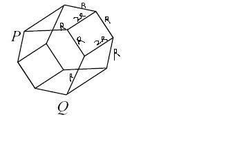

look at my diagram:
Hand-drawn wireframe diagram of a three-dimensional polyhedron with points P at the upper left and Q at the bottom, with edges labelled R, 2R and R in several places.
The ratios R/R and R/R are equal. They form a balanced wheatstone bridge, which means that there is no current through the 2R resistance. We can apply the same to all the corresponding branches and remove them one by one. I still don't understand where is my mistake.

You have 6 wires labeled with R & 2 labeled with 2R. Which are you taking the ratio of, and where do you connect the supply voltage?

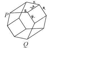

Wire-frame circuit diagram of a hexagonal prism-like cube network with corners labelled P and Q, each edge marked with a resistor symbol labelled R.
This might be more clear. Supply voltage is connected across PQ.

Abdul Quadeer said:
Wire-frame diagram of a three-dimensional hexagonal prism-like network of edges, with vertices labeled P at the upper left and Q at the bottom, and resistor labels R, R and R written along the upper edges.
It looks like your Wheatstone bridge has the 2R wire where you would normally place the galvanometer. The problem with this is that the legs of the bridge (2 pairs of R wires) are not connected directly together. The legs are connected by 2R wires (unlabeled here). These extra wires put the bridge WAY out of balance.Yes, for your double hexagon circuit, the supply voltage is across P & Q -- that was very clear. There are lots of other resistors & connections between P & Q and what you want to use as a Wheatstone bridge.

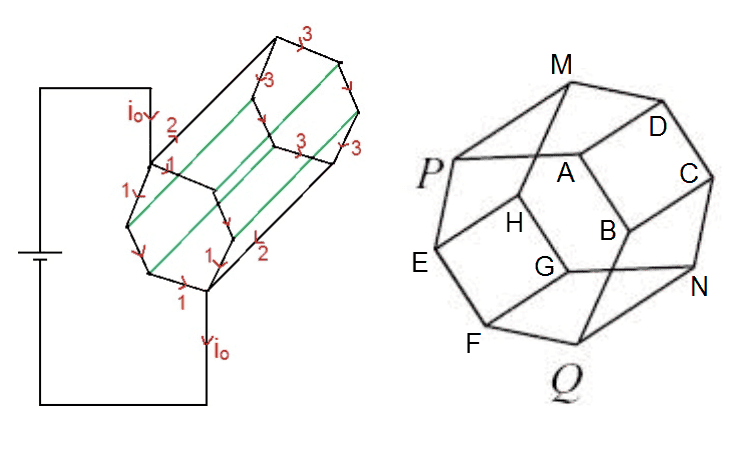

I have labeled the junctions on the Original Image, and merged a copy of cupid's image.
Left: circuit diagram of a battery feeding a hexagonal prism resistor network with green edges and red numbered junction labels 1, 2 and 3. Right: wireframe of a hexagonal prism with vertices labelled M, D, C, N, Q, F, E, P, A, B, G, H.
By symmetry, A & E are at the same potential, so they can be treated as if the are connected by 0Ω wires, i.e. they form a node. The same is true for the pairs, B & F, C & G, and D & H.
Notice, that b/c A & B are not at the same potential, current will flow from A to D to C to B, as well as directly from A to B.
  • Left: circuit schematic of a battery connected to a hexagonal prism wireframe with green edges, junctions labeled 1, 2, 3 and currents i0. Right: wireframe hexagonal prism with vertices labeled M, D, C, N, Q, F, E, P, A, B, G, H.
Left: a battery and resistor network drawn on a hexagonal prism, with edges labeled 1, 2, 3 and current i0 entering and leaving. Right: a truncated-cube style wireframe graph with vertices labeled M, D, C, A, B, H, G, N, E, F, P and Q.
But if you imagine A&E to be connected by 0Ω wire the current can flow from A to E or vice versa.
currents don't flow b/w two same potential connected points if there is some resistance connected in between.
* I'm not talking about this case but in general taking this assumption will not be correct

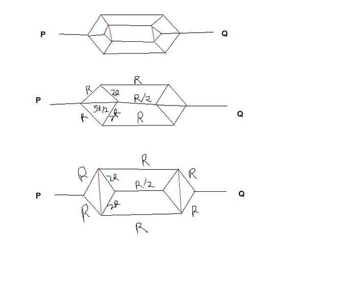

Ok, this is how I proceed to solve the problem-
If you push the hexagon surface containing P and Q to form the outer hexagon in 2-D, you get the following figure-
Three hand-drawn circuit diagrams of a hexagonal prism resistor network with terminals P and Q; the lower two label edges R, R/2 and 2R, with a red line joining same-potential nodes.
I connected same potential points with a red line. In the 2nd figure, the 5R/2 resistance is redundant as it forms the 'galvanometer' of the balanced wheat stone bridge. Simplifying the circuit further, I got 17R/12 as the equivalent resistance. Why different?
  • Three hand-drawn circuit diagrams of a hexagonal prism resistor network with terminals P and Q, showing resistances labelled R, R/2 and 2R with red lines joining equal-potential nodes.
Points A & E are at the same potential because of symmetry. If they are at the same potential, then connecting them with a perfect conductor will NOT change how current flows, but it will make the problem much easier to solve. This is one of the main features of solving a circuit problem by use of symmetry.
Three hand-drawn resistor network diagrams between terminals P and Q, showing a hexagonal prism reduced step by step; labels include R, 2R, R/2, 5R/2 and R on the branches.
Where did the 5R/2 wires go ? (2nd to 3rd sketches)
I wrote the reason below the image-
But then won't the current flow through least resistant path (conductor in this case)
This is how short-circuiting is done
Cupid is correct here!
That's a balanced Wheatstone bridge connected "sideways". You can't eliminate the 5R/2 by this method.
The nested hexagon diagram elucidates the symmetries in the circuit that can be exploited. If you take that diagram and draw a line through PQ, the portion of the circuit above the line is completely symmetrical with the portion below. That means that all "mirror image" currents and voltages are equal. This allows us to commit the following act of violence upon the circuit.:smile:
If you "fold" the circuit along line PQ so that all the corresponding points of the upper half join in parallel with their lower half, then no new currents should flow (because all corresponding points have the same potential). The net result is that we can dispense with half the circuit provided that we divide all the "folded" resistances in half (note that components lying along the fold line are not "folded", but remain the same). The resulting simpler circuit is quite amenable to further simplification.
