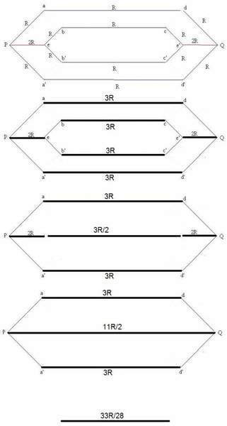

smaller than 1.7R ?
Here's how i solved ... Bold black lines are the resistances
Four stacked circuit diagrams of a resistor network between terminals P and Q, with branches labelled R, 3R, 3R/2, 2R, 11R/2 and 33R/28, the last shown as a bold line at the bottom.
  • Four stacked circuit diagrams of a resistor network between terminals P and Q, showing successive reductions with bold black wires labelled 3R, 3R/2, 11R/2, and a final value of 33R/28.
there won't be any current through them right? so we can just remove them. Is that wrong ?:confused:

I don't think that you can assume that there will be no current through them.
gneill said:
Sure. I've only labeled some of the resistances, the rest should be obvious by color code and symmetry.
Did you get 17R/16?
Here's the next step in the simplification. The diagram is still symmetrical, so the Delta-Y transformations at either end will be the same...

Abdul Quadeer said:
I got it - 23R/20
Thanks!
Yes, that's it. Attached is the summary of the simplifications used.
  • Four-stage circuit reduction diagram from P to Q: a hexagonal resistor network with labels R, 2R and R/2 simplified step by step, ending in a single resistor labelled (23/20)R between P and Q.
