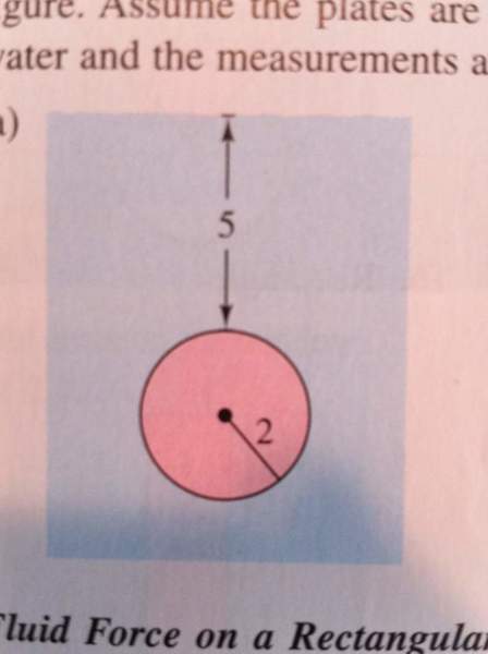

Find the fluid force on the circular plate shown in figure (see attachment). Assume the plates are in the wall of a tank filled with water and the measurements are given in feet.
F=w∫h(y)L(y) dy
I have that h(y)= 7-y and L(y)=2√(4-y^2). Therefore, F=2(62.4)∫(7-y)√(4-y^2) dy from y=0 to y=4. Can someone please help me find the integrate of this equation. Thanks!

hi kari82! :smile:
(try using the X2 icon just above the Reply box :wink:)
kari82 said:
… Therefore, F=2(62.4)∫(7-y)√(4-y^2) dy from y=0 to y=4. Can someone please help me find the integrate of this equation. Thanks!
you have ∫ (7 - y)√(4 - y2) dy, so just split it up …
∫ 7√(4 - y2) dy can be solved by a trig substitution, and
∫ y√(4 - y2) dy is obvious! :wink:
