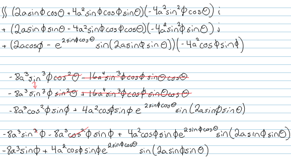

Using spherical coordinates I achieve N = 4asin(phi)cos(theta) i + 4asin(phi)sin(theta) j + 4asin(phi)cos(phi) k
But when subbing in spherical to F, then F dot N, I can only simplify to a very messy integral of: -8a^3sin(phi) + 4a^2cos(phi)sin(phi) * e^(2sin(phi)cos(theta) * sin(2asin(phi)sin(theta)
Any help would be appreciated :)
Show the steps of your simplification; I get [itex]2a-e^{2a\sin\theta\cos\phi}\sin\left(2a\sin\theta\sin\phi\right)[/itex] for [itex]\textbf{F}\cdot\textbf{n}[/itex].
and yes radius is 2a
Your integrand should be
[tex]8a^3\sin\phi - 4a^2\sin\phi\cos\phi e^{2a\sin\phi\cos\theta}\sin(2a\sin\phi\sin\theta)[/tex]
okay I forgot the a on my e^(...) and I simply used -N so the switch of signs means nothing. Where do I go from here? Or is there another way to approach this problem? Stokes Theorem?
Of course, the divergence theorem is the easy and obvious way but you ruled that out.
However, you almost have it. Notice that your second term is an odd function of theta. That means if you integrate theta from -pi to pi (which is just as good as 0 to 2pi) you will get zero. So all that is left is to do the double integral on the first term.
[tex]\int_0^{2\pi}\int_0^\pi -8a^2 \sin\phi\ d\phi d\theta[/tex]
which will give you the same answer as the trivial application of the divergence theorem.
