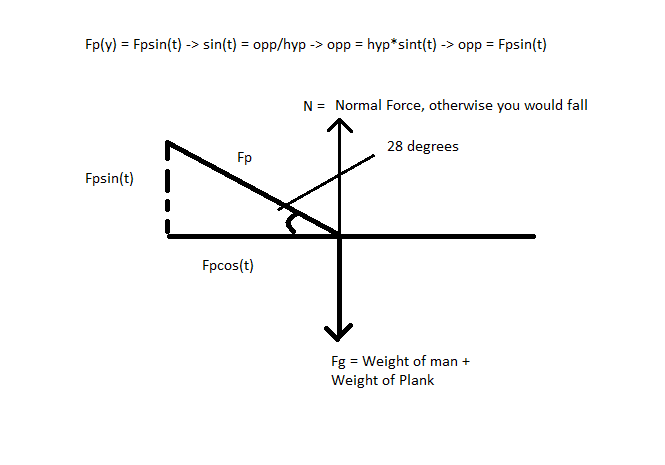

A 27.5 kg person stands on a 55 kg platform. He pulls on the rope that is attached to the platform via the frictionless lower-right pulley. He pulls the rope at an angle of 29◦ to the horizontal, as shown in the figure below. Assume: g = 9.8 m/s2 . Ignore friction. The platform remains level.
If he pulls the platform up at a steady rate, how much force is he pulling on the rope?
Fnet=ma
I don't know where to start. I don't understand what my free body diagram would look like. Would it be the weight of the person and platform combined, with Force up and w down? I'm just really confused.
well its not a complicated FBD, the man standing with the combination of the platform contribute a FG downwards, but the platform contributes a Normal forces to keep the system in the Y direction in equilibrium (before he pulls on the rope).
initially (not pulling on rope)
Fy = N - Fg = 0; therefor Fg = N
when pulling the rope, you break down your y component of your force
Fy = N - Fg + Fpsin(t) = ma; Fp is the force of you pulling on the rope, but you only want the y component.
and
Fx = Fpcos(t) = 0 ; but the guys trying to go up, not side to side; therefor its zero
hope that helps
  • Hand-drawn free-body diagram with a sloped line labelled Fp, a dashed vertical component Fpsin(t), a horizontal component Fpcos(t), an upward arrow N for normal force, a downward arrow Fg for weight of man plus weight of plank, and a 28 degrees angle marked.
All of that makes sense but then I get that:
F(sint)=82.5a
I don't have acceleration to find out what the force should be.

Forces in Y = -(M1+M2)g+Fsin(t) = 0; //M1 = mass of man, M2 = mass of plank
solve for F
Okay, so:
-(27.5+55)*(9.8)+Fsin(29)=0
-808.5+Fsin(29)=0
Fsin(29)=808.5
F=808.5/sin(29)
F=1667.664927 N
Which isn't an answer choice.
