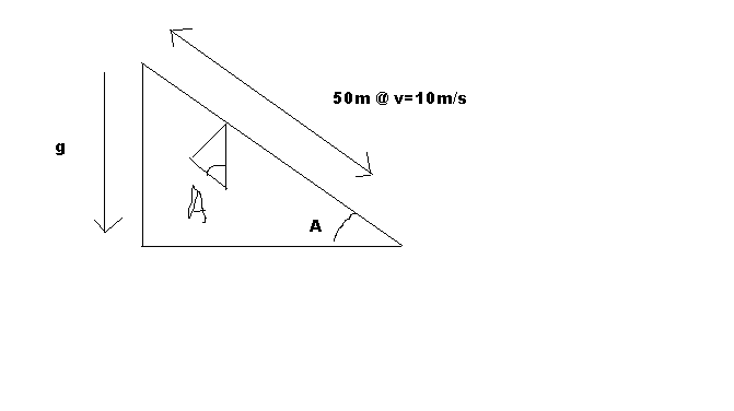

the best thing to do is draw a picture it helps a lot
i drew this but i think i mucked up, that A should be in the top left of the of the large triangle because the angle i go would mean acceleration would be close to g if A was where i drew it.all i know is that i got 84.15 degrees. which i don't think is right and now this will bug me...
but yes the acceleration down the hill is 1m/s
Liquidxlax said:
its been a long long time since I've done this kind of physics

Nevermind I figured it out with my friend.
If you use sin rule you can get the angle
then tan of that angle is the gradient.
