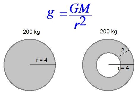

Consider the 2 objects in the pic. They both have the same mass of 200 kg. They both have a radius of 4 meters. However, the object on the right is hollow, with the walls being 2 meters thick. For the gravity equation, and the object on the right, does one use a radius of 4 squared, or the wall thickness of 2 squared?

Outside of either object, the mass acts as a point mass at the center as far as gravitational attraction is concerned.
Just to avoid confusion, we're looking for gravity of each individual object, not the attraction between them.
I was actually thinking of a formula that included the radius of the hollow section (r) and total radius (R).
g = Gm/(R+r)(R-r)
Not so sure tho... Its probably just the normal formula of g = Gm/r^2

So, did you not believe what I told you in post #2 ?

It's not obvious, but Newton proved that you can use the center of the object. (see https://en.wikipedia.org/wiki/Shell_theorem )

As I read it, "the gravity of each individual object" is intended to mean the acceleration of an ideal test particle under the influence of the object's gravity, that is, the quantity ##Gm/r^2## for these spherically symmetric objects, and the question is what is the approriate value of ##r## to use in the calculation.

But with the addition of the equation ##g=\frac{GM}{r^2}## found in the OP, that would suggests that ##r## is always the distance from the center of mass of the object to a point on the outside surface of the object (where the ideal test particle is), no matter the shape of that object. That is what I was trying to point out.
My "gravity" - if I have a mass of 75 kg, measure 180 cm high and 40 cm wide - is 6.18 X 10-9 m/s2 (##r## = 90 cm) for a particle on top of my head and 1.25 X 10-7 m/s2(##r## = 20 cm) for one on the side of my waist. If I was a sphere, then my ""gravity" would be the same for any point at my surface since the distance ##r## would be the same everywhere.

Since you are not a sphere, Newton's shell theorem does not apply and a simple inverse square calculation will not work. The results above are not correct.
You would have to integrate your body mass density divided by r3 and multiplied by ##\vec{r}## over the volume of your body to get the net gravitational effect on a test particle at a particular point.
