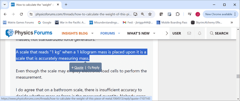

Quote repaired. Simple quotation marks are inelegant.
There are two ways to get an attributed quote like the one above. One is to mouse over the text that you wish to quote, highlighting it. e.g.
Then when preparing a response that you wish to make, there should be an Insert quotes push button below the editting window.
The other way is easier. Just click reply and edit out everything other than the passage that you wish to quote.

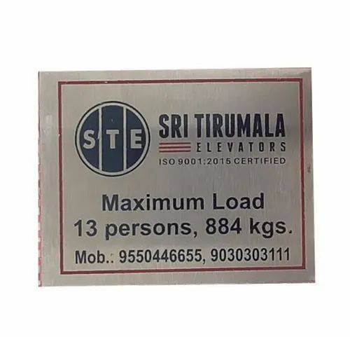

Must nameplates of equipment shows “maximum capacity / allowed load”, which may imply force rather than mass (at least to this old fashion fool).
In the engineer world of the second half of the last century that I knew, kg-force and lb-force (and all related units) were of common use.
No, the load rating of a lift system is a mass rating: a force rating would be useless because when you use a lift you do not know how fast it can accelerate (or, usually more critically, brake) any given mass so you would not know how much force you would be loading it with.
The designers of the system do know this, and they use it to convert the safe working load of the cable gear to a maximum load mass.
