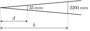

Hello,just seeing if someone can help me on here,i have a rc glider measuring 2200 mm on the ground,when in the air it measures about 35mm. Can the the height be calculated from these measurements.

cloned33 said:
Hello, just seeing if someone can help me on here. I have a rc glider measuring 2200 mm on the ground; when in the air it
What do you mean by "it" here? The shadow on the ground? Or the silhouette?
No, the height depends on what distance from the eye the image of the glider measures 35 mm. If you hold a ruler in a stretched hand and the glider seems to measure 35 mm, that's quite different from when hold the ruler right next to your eye. So, 35 mm alone is not a meaningful measurement, you also need to add the distance $d$ from the eye so that that 35 mm at this distance seems like 1200 mm at real distance $h$.
In that case, $h=\frac{1200}{35}d$.

hello,im not into maths but ill try to explain what I want to solve. if I met you and I thought you was 6foot tall, if you then walked away from me till you only looked 1inch tall,whats the distance from where you stood to where you stopped
thank you for the reply,I see I need to go back to school this all seems way above my head.to me it seemed a straight forward calculation but nothings simple these days regards martin
