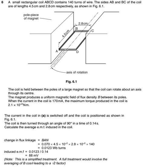

Another question inquired me to calculate the change of flux when the change in θ is from 0 to 90. I used the normal way of multiplying BA by (cos 90 - cos 0). However, the examiner stated that this is simplified treatment, a rigorous method would involve averaging of cos θ leading to a factor of 1/sqrt2.
How is this factor achieved? I tried to calculate the mean value of cos θ using integration but the answer was different.
There must be a misunderstanding there. Do you have the full litteral text of thte question that was asked you ?
No I meant, if I wanted to calculate the change in a value of a function at the interval ##a## and ##b##, I will calculate ##f(b)-f(a) \neq f(b-a)##. But in the provided example taking ##cos(90-1)## gave the answer. How was that possible?

In the 89 degree case the change in flux was asked for. That is a simple difference.
In exercise 6 they explicitly ask for an average emf. Do you have a relationship (formula, expression) that links ##\Phi## to the emf ?

Write ##\theta## as a function of ##t## and you can take the average of V for a quarter turn in 0.14 s: $$<V> = {1\over 0.14}\int_0^{0.14 s} V\,dt$$
And how do I write theta as a function of t?
I tried 0.14/90 t = theta but ended up getting the wrong answer
You may assume it turns with a constant angular speed from ##\pi\over4## to ##0## in 0.14 seconds
[edit] sorry,: yes, that should be ##\pi\over 2##.

Don't you mean pi/2? The rotation is of 0 to 90 degrees.
Is this correct?
$$ <V> = \frac{0.0123}{0.14}\int^{0.14}_0 \cos{\frac{90}{0.14}t}~ dt $$
