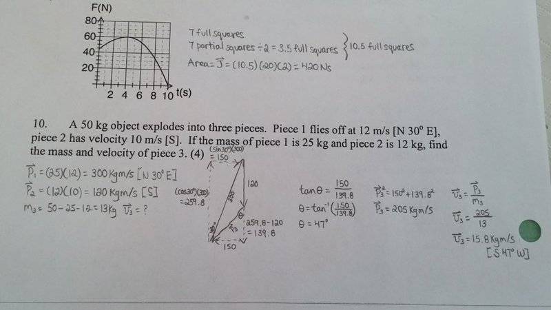

A 50kg object explodes into three pieces. Piece 1 flies off at 12m/s [N 30o E], piece 2 has velocity 10m/s [ S ]. If the mass of piece 1 is 25kg and piece 2 is 12kg, find the mass and velocity of piece 3.
My attempt is shown below. Can anyone confirm my work? Not sure if my vector diagram is drawn correctly. Thanks! All help is very much appreciated!
  • Handwritten solution to a momentum problem: a force-time graph with area calculation 420 Ns, then vector sums, a triangle of momentum vectors with 150 and 120 sides, and the velocity of piece 3 found as 15.8 kg m/s.

I don't think that is correct.
you should divide momentum into components (x and y)
furthermore, what is V3= xxx Kg*m/s ... are kg*m/s a velocity dimension?
The working looks good, solving from the vector diagram. The correct vector was identified that makes the net momentum zero, and its components determined.
The answer should read 15.8 m/s not 15.8 kgm/s. My bad.

yeah.. and the answer is correct sorry, my bad.
