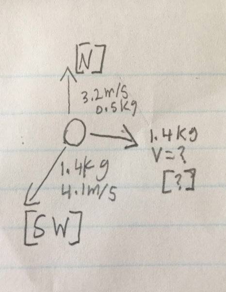

A pumpkin of mass 3.30kg at rest on a smooth frictionless plane, explodes into 3 pieces in the horizontal plane. A .50kg piece flies to the North at 3.2m/s. A 1.4kg piece flies off (SW) at 4.1m/s.
What is the speed, direction and mass of the third piece?
M1V1o + M2V2o = M1V1f + M2V2f
I assumed the piece was 1.4kg as I subtracted the original pumpkins mass by the known fragmentary masses. I used the conservation of momentum to subtract the original pumpkins mass and velocity by the unknown fragment and equaled it to the two known pieces. M1V1o - M3V3f = M1V1f + M2V2f
This yielded -5.2 as a velocity which seems wrong, and I have no idea how to find the direction of the third piece and no angles were included.

Here’s a diagram

Here’s a diagram
Hello @Forerunner546 . :welcome:
Your equations are vector equations, because momentum is a vector quantity. So is velocity.
What is the initial momentum ?

There is no initial momentum
Right. So write out the momentum conservation equations for two orthogonal directions.
By this I assume that you mean: the initial momentum is zero.
That's correct.
You can also solve this by arranging the momentum vectors in a triangle and using Law of Cosines and/or Law of Sines.
