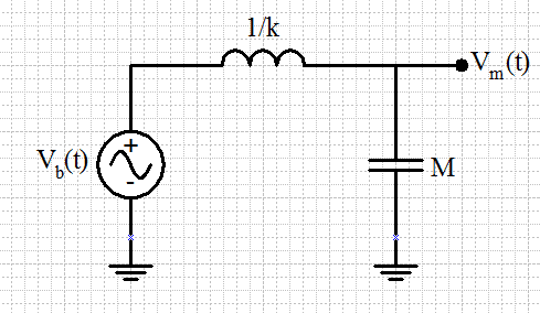

"Describe" - I don't think you have to calculate it (and I don't think you can without damping coefficient).
If the problem is seeking a phase difference at steady-state (after the support rod has been vibrating at some fixed frequency for a "long" time), then the problem should be amenable to analysis.
Converting the mechanical problem to an electrical analog it would look something like this:
In this analog, springs become inducatances, masses become capacitances. Velocities are voltages and forces are currents.
In the figure ##V_b(t)## is the support rod velocity (not the displacement), and ##V_m(t)## is the mass velocity. The usual steady-state analysis methods for electric circuits can be applied to obtain the output in terms of the input. Yes it'll be a velocity function and not a displacement, but an integration will take care of that.
