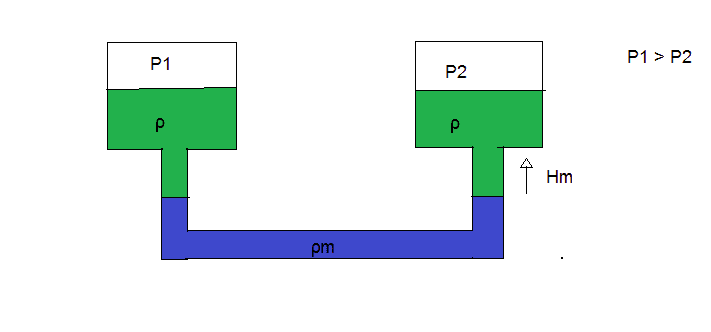

See attached image. Two cylinders of the same diameter D contain the same incompressible (green) gas of density rho. Their bases are connected via a tube of diameter d containing an incompressible fluid of density rho m. The system is in equilibrium if the pressure on both cylinders is P atm.
If we supply different pressures P1 and P2 to each of the cylinders respectively, the fluid on the right hand side will rise by a height of Hm.
Express the difference P1 - P2 in terms of the given variables.
I'd say P1 = P2 + rhom*gHm, so I'd just solve for P1-P2 and I'd have the answer, but something tells me I'm neglecting something. I neglected the contributions of the gas of density rho on both sides since I figure they would cancel out, am I doing this correctly?
  • Diagram of a U-tube manometer: two cylinders with green fluid labelled rho, marked P1 and P2 above the liquid, connected at the bottom by a tube with blue fluid labelled rho m, with Hm marked as a rise on the right, and P1 > P2 noted.
That's the right answer, because an incompressible gas doesn't behave differently from the incompressible fluid. However, are you sure it's supposed to be an incompressible gas? I don't think those exist--by definition, the molecules of a gas interact very weakly, so the gas is very compressible.
Whoops, you're right, the green substance in question is also a liquid, so no gases. Thanks.
