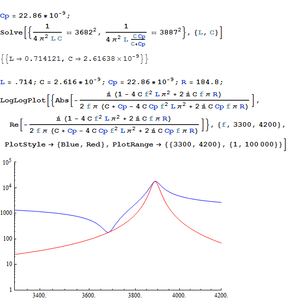

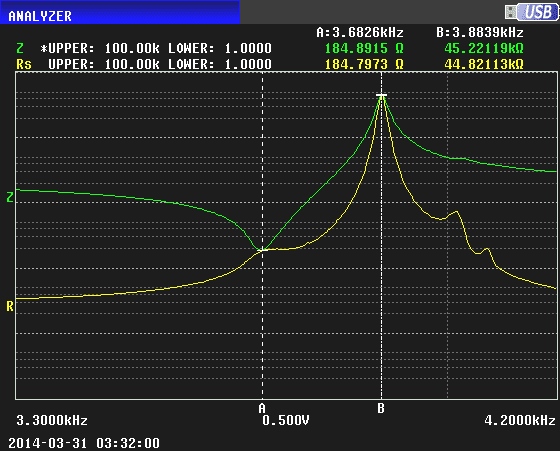

Would it suffice for your purpose to determine the values in the model found at:
https://www.efunda.com/materials/piezo/electronics/elec_equiv_circuit.cfm
I have a piezo disc from a computer which I measured with an impedance analyzer. I get the following result (impedance magnitude Z in green, real part of the impedance Rs in yellow). The measurement was made over a frequency range including the first major resonance:
I measured Cp at 100 Hz and using the equations given in the reference, solved for L and C. I took R to just be its measured value at the series resonance, 184.8 ohms. Then I plotted Z and Rs using the expression for the impedance of the model:
The calculated plot is similar to the measured impedance, but the shape of the Rs curve is a little different, indicating that the simple model doesn't include some non-idealities.
Although you can calculate the Q using an equivalent circuit approach, what I want to do is use several more points than the simple method suggests.
My goal is to include several points to calculate Q, thereby getting a more accurate and repeatable measurements.
