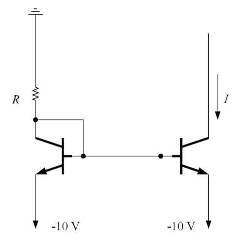

I have this circuit
Circuit schematic of a two-transistor current mirror: a resistor R from ground to the base-collector node of the left NPN transistor, whose base is tied to the base of the right transistor; both emitters go to -10 V, and current I is marked flowing into the right transistor's collector.
Where I have to find R given that I=2mA, and Beta =200
Ic=Beta Ib
Ie = Ic+Ib
I would have thought that the voltage Vb would be -9.3V, since we have Vbe = 0.7 and at the bottom we are given -10V. Then I would just use this voltage along with the ground, and the current I is also the current going through the resistor (since it is a current mirror) and then find R=4.65kohm. But then, the second question is how would R change is beta is 100.
I don't see what role Beta plays. Maybe I am just tired, this is a really basic circuit. I don't see the point in finding Ib with beta and Ic. We could then find Ie, but I also don't see how this helps. I just don't know how to use this beta.
Thanks,

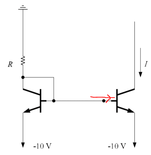

mfb said:
Where would the base current come from if the currents on both sides would be identical?
Circuit schematic of two bipolar NPN transistors with a resistor R from ground to the left transistor's collector-base node, both emitters at -10 V, and a current I labelled on the right transistor's collector; a red hand-drawn arrow points to the base connection of the right transistor.
Where I drew the red. So does that mean the current in the branch that connects B and C in the transistor in the left is 0 or ?
That's where it goes into the transistor, but where does it come from?
Can you see how this breaks the symmetry?
