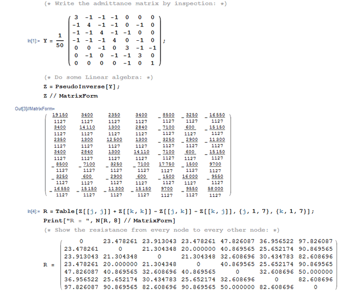

For doubleplusgood credit, calculate the resistance from every node to every other node. First number all the nodes in the original network.
Then do the math:
In the final result matrix the resistance from node j to node k is given by the (j,k) element of the matrix. The resistance from node j to k is, of course, the same as the resistance from node k to node j, hence the matrix is symmetric. And we see all zeroes on the main diagonal because the resistance from a node to itself is zero.

I am now curious, since I just went through a Linear Algebra course: what is the key to creating the Admittance matrix by inspection?
