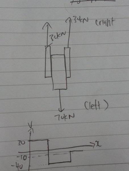

  • #33
chetzread said:
i really have no idea . i haven't learn the shear force diagram
I think that shear force diagrams have featured in some of your other threads ?
No matter . Can you sketch any sort of diagram showing the forces acting on the pin ?

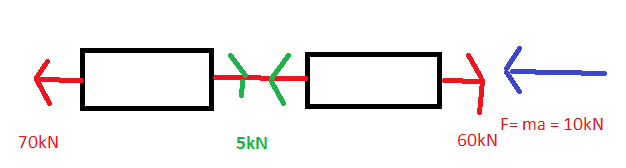

  • #37
I can understand it, but it seems that your diagram doesn't suit my case, coz, I have 2 parts of the plane, one plane is subjected to 2 total smaller force, and one bigger force to right
  • #38
Well, my Friend. You Should listen to What other Advisors said to You...
  • #39
chetzread said:
How if the mass is not negligible, then how the shearing force is?
If the mass of the left part is equal to the mass of the right part then the shear force will be 65kN.
You have 70kN pulling to the left, and 60kN pulling to the right.
Acceleration will be 10kN/mass of the free-body (pointing to the left).
Inertial reaction force on the right part will be acceleration x mass of the right part.
The mass of the right part equals half the mass of the free-body:
Acceleration x mass/2 = (10kN/mass) x (mass/2) = 5kN.

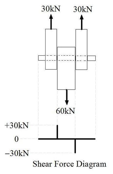

  • #40
Nidum said:
So what does the shear force diagram for the pin look like ?
  • #41
if we consider the force from left side , the shear force would be = 70-5= 65kN ?

  • #44
chetzread said:
If we consider the force from left side, the shear force would be = 70-5= 65kN ?
Yes. There is a 65kN shear force acting on the pin (pointing to the left), and there is a 5kN inertial reaction force acting on the left part (pointing to the right).
  • #45
chetzread said:
Is there anything to do with the shear force diagram? BTW, I have tried to sketch and here it is:
That is not what I came up with. The pin does not experience any shear force except at the faces where the parts are joined. The SFD looks like the Greek letter π except one vertical leg is pointing up.
When the left side of a member is pushing up, and the right side is pushing down, shear force is considered positive, by convention. Look at the SFD attached to post #40.
  • #46
can i explain in this way ? Since the acceleration for each block is 5kN( 5kN act to the right for left block) , so considering the left block , the shear force 70-5 = 65kN ?

  • #47
why ?
  • #48
If you have a body floating in deep space, tie a rope to it and pull it to the left, the body will exert an equal and opposite inertial reaction force to the right.
chetzread said:
Since the acceleration for each block is 5kN...
Remember to divide force by mass to get acceleration.
The physical quantity will work out to distance/time2.
  • #49
do you mean for the block on the left , the acceleration force one block is 5kN to the left , so opposite inertia force is 5kN to the right ?
But , i am curious about the block on the right , from the diagram i sketched in post #46 , the 5kN act to the left for the right block , so , there will also be an opposite inertia force of 5kN act to the right ?
  • #50
Both 5kN inertial force vector arrows (green?) should point to the right since the body is accelerating to the left.
If the blue vector arrow represents acceleration in your diagram, you could label it acceleration or 10kN/mass.
