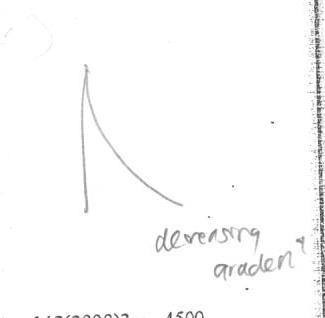

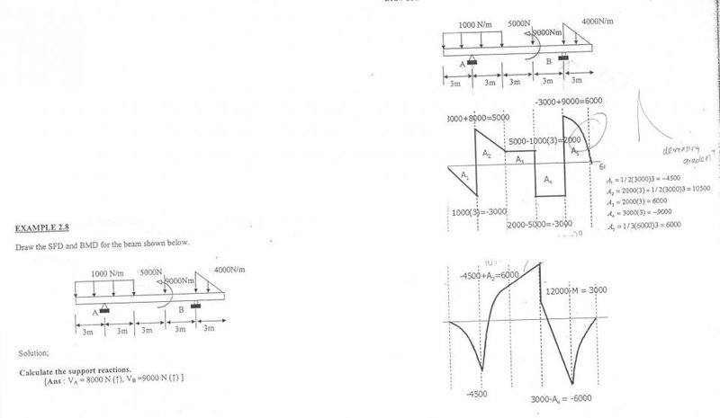

There are 2 graphs in the notes , the first represent the shear force diagram , while the secon d one represent the bending moment diagram... In the notes , we can see that the gradient of the force per meter to the right of B is decreasing ...
So , i think the shear force diagram at that particular part is wrong .. It should look like this , right ? ( in the second picture)
