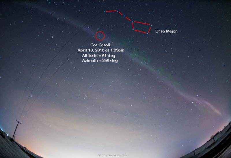

  • #62
Actually, this is a much clearer pic.
I believe that STEVE is the blue/purple arc above the green pickets, yes?
  • #63
Yes Dave, that is STEVE.

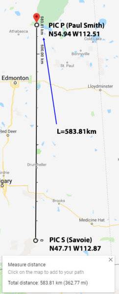

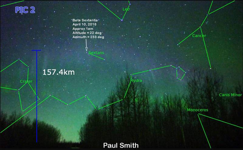

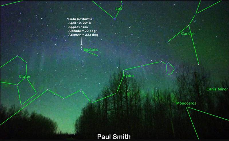

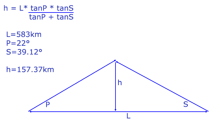

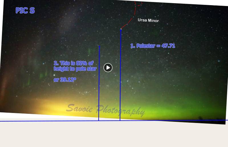

Welcome Bill. Here is how Dave came up with the 157.4 Km. I Think it looks better if you go back to page 3 in this thread because the original post looks better than this "Quoted" post.
DaveC426913 said:
OK, here's what I get:
So, total distance 583.81km (looks like you meant 370 miles).
PIC S (Savoie)
Angle of Polestar = latitude of observer.
So angle of polestar in pic S is 47.71
I picked the top of that group of spikes as a reference point.
It is 82% of the height of the polestar, which would make it an angle of 39.12 degrees (82% of 47.71).
PIC P (Paul Smith)
Angle here is a given of 22 degrees.
I assume here that I have the same reference point as in PIC S - a whopping assumption.
This gives the following geometry:
I used this handy calculator: to arrive at a height of 157.37km
This gives an altitude of that bit of aurora of 157.4km.
As to what that means in relation to the altitude of STEVE, do with it what you will.

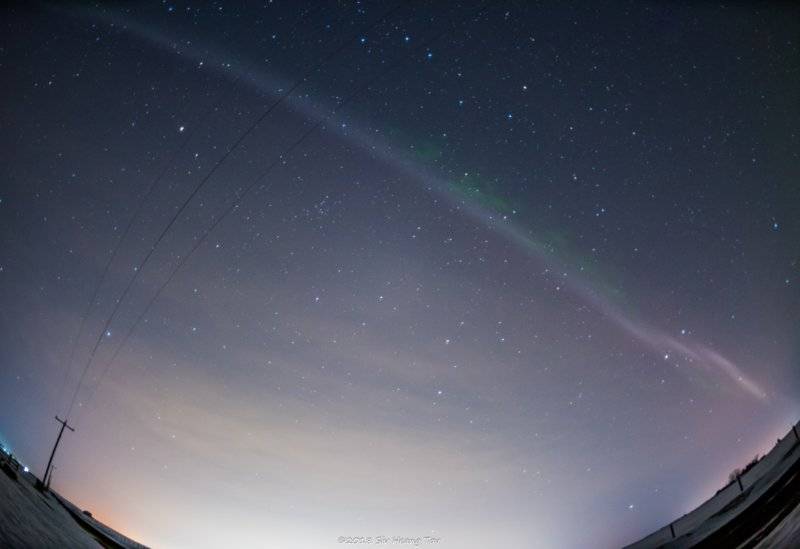

Siv Heang Tav... That is a nice capture. Can you post your GPS location for the photos you took that evening?

51.239535,-113.795572
That was my location from Google map
  • #72
Thanks Siv. I'm going to check the starmap for 1:39am and the location you just posted. I'll post a pic later with the info.

Siv Heang Tav...Here is the astrometry results I found. We will have to go through the images we have so far to see if this could help in making the necessary calculations. Thanks.

astroscout said:
Dave and Bill...To get a precise calculation we will need the help of the AAC members on the next STEVE event.
A smidgen of advice: Use "@" + "member name" (for example: @gneill) to signal the participants. It will generate an alert in their ALERTS dropdown that will garner their attention. We often use it to "call" mentors or science advisers or homework helpers with the requisite skillset or knowledge base to help with a given problem. It's more efficient than waiting for them to read the thread. Hope this helps. Cheers.
  • #78
astroscout said:
Also, if the distance between the photographers is great, then we have to factor in the curvature of the earth.
:slaps forehead:
Didn't even take that into account. Those photos are taken (39-22=) 17 degrees apart! Yet my diagram treats the Earth as flat!
Don't rely on me to do this stuff with any accuracy. There are zillions of members better at this than me.

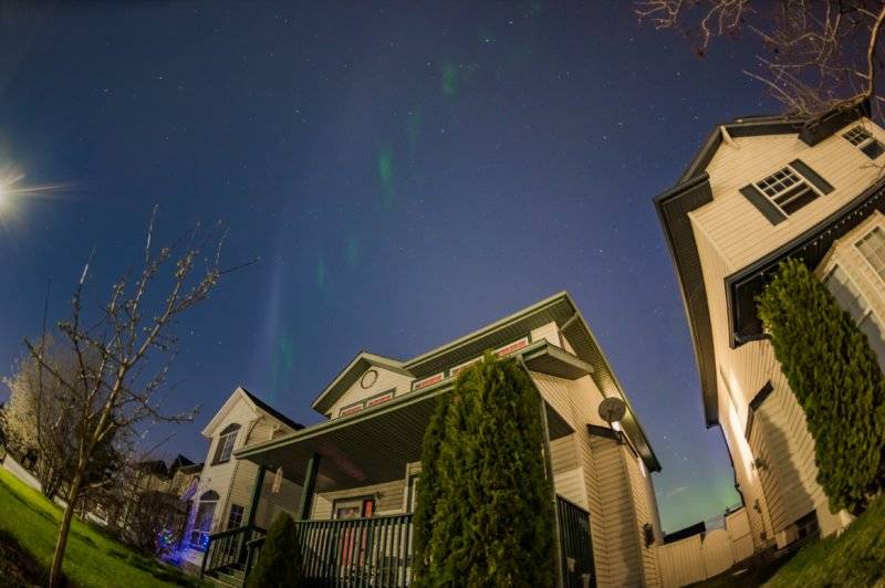

@astroscout You can post a threat on Alberta aurora chaser group, many of our chasers willing to help and provide our images for sure. We just need to know what kind of position u need so we won't focus too much on our foreground lol...
May 06 2018 was a strong Steve over head too

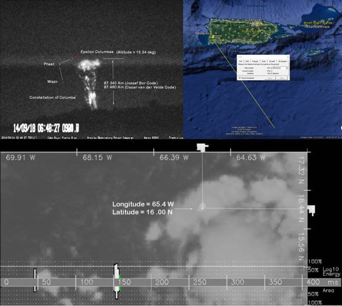

@DaveC426913 Thanks to your efforts we were able to wind up in the ballpark of 170 Km, so we are getting close. A few months ago I took on the task of finding the height of a Gigantic Jet Lightning discharge that I captured over the Caribbean. These Jets travel from the top of a storm cloud and reach very near the Ionosphere at about 90 Km. Here is the data I gathered to attempt to find its height.
1. I contacted Michael J Peterson to find the Goes16 imagery of the cloud that hosted this GJ.
2. From that data I was able to find the exact GPS location of the storm cloud.
3. In Google Earth I was able to find the distance between me and the storm cloud.
4. I then used starry night to find the altitude of a star that was at the same height of the GJ.
5. I found Epsilon Columbae to be a good reference star so I used it's altitude as the angle.
I then used an online calculator and it was way off so I posted my results in my facebook group and Jozsef Bor sent me a code that I could use that will take into consideration the curvature of the earth. The final result came out to be approx 87 Km, so I was well within the ballpark of 90 Km.
Unfortunately, this code can't be used for STEVE because we would need the exact GPS location of STEVE on the ground and we all know that STEVE doesn't shoot up from the ground. The attached image shows the data I gathered.
