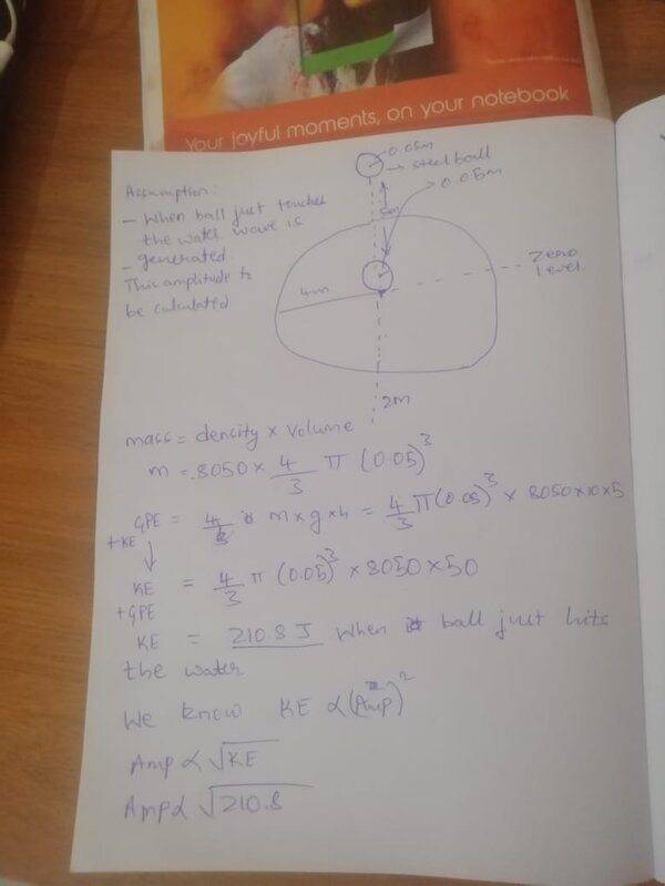

Find the solution here.
This can give the amplitude of the wave when steel ball just touches the water surface. One last step is remaining in this. Just check if it can be good to go.
  • Skeptical
Apart from the impossible-to-read light-light-light blue on white color scheme that you chose, your units aren't even correct. Height is not measured in the square root of joules.
Okie. My equation never says height is measured in the square root of joules. But I have told amplitude is proportional to square root of joules. Hope this is clear. If you have to say anything on solution kindly comment. Will be happy to learn.
Also I have mentioned, I have not arrived at solution but one or two steps to this relation can lead to solution.
Is distance proportional to speed? Does it mean you measure speed in meters or distance in m/s.
If anything not okie in this derivation / part solution pls suggest me.
I don't think it will be so simple. To me at least it would seem that the amplitude will depend on lots of different factors, for instance viscosity and surface tension - which are not part of your working. Also, the actual period of contact looks very complicated. And the resulting pattern of the water, as @Vanadium 50 alluded to in #7, doesn't look sinusoidal at all!

Yeah true not a solution. But this can be extended to the solution. Want to know if the assumption i made and the thought process is right? If so can extend the solution.

If you want to be sure that people can actually read what you have written then you could very easily take that hardly-readable image and give it some help. Put the jpeg into your 'photo application, increase the contrast and take the gain so the the white is actually white and the writing is very dark grey. That's what the most basic photocopier does automatically if you tell it to do a black and white image; you are computer savvy so you could do it too and the result would be that more people would be bothered to read your posting. :smile:
