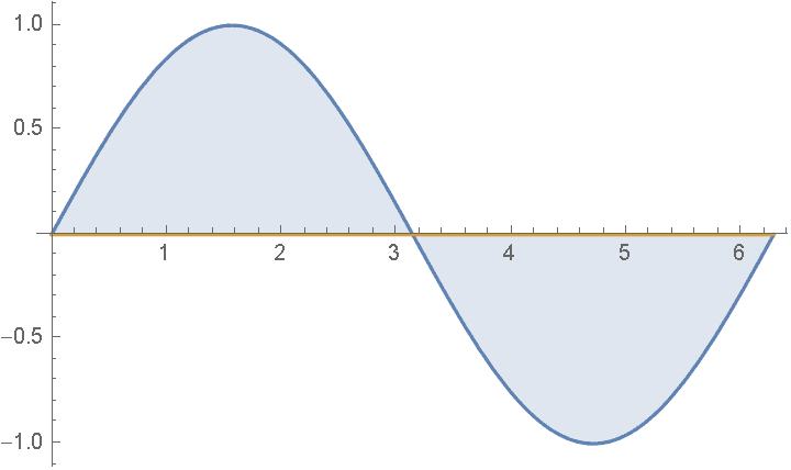

I think that you have to be careful about the use of the expression "area under the curve" to explain the integral. If you take
\int_0^{2 \pi} \sin x \, dx = 0
you get zero because the integral over ##(0,\pi)## cancels out the integral over ##(\pi,2 \pi)##. But if you are interested in the (surface) area between the sine curve and the x-axis, i.e., between ##f(x) = sin(x)## and ##g(x) = 0##,
then you have to consider that two functions cross at ##x = \pi## and the result will be
\int_0^{\pi} (\sin x - 0) \, dx + \int_{\pi}^{2 \pi} (0 - \sin x) \, dx = 4
